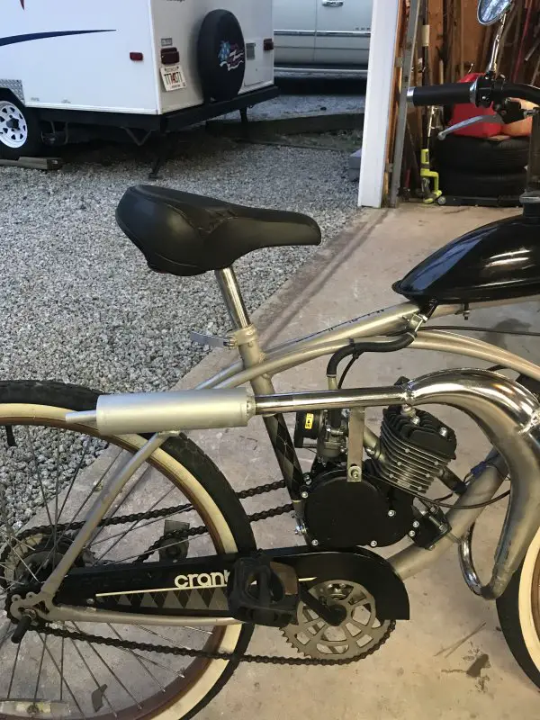

My walmart bike is this, I dont know what my road bike is
Greg58
May 1, 2011
5,353
2,575
66
Newnan,Georgia
That bike will work, I suggest you remove or re-brace the fenders, pack the bearings on both wheels and go for it. I have a Cranbrook from there that has had a engine on it for 10 years, I replaced the rear hub with a shimano because the guy that installed the sprocket got the bearings too tight. I add a front side pull BMX brake to every coaster brake bike I build, 96mm reach worked on the cranbrook.
