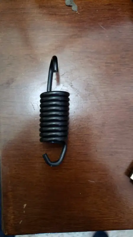

Just got the motor rebuilt (brother in law hookup on a badly seated piston ring & new head gasket / Hone & polish)
anyway re-assembly has been good except i appear to have lost the spring that tensions the slipper/pulley assembly
any suggestions on correct dimensions/where to find a replacement? (my mechanic is just as perplexed at finding a replacement lol)

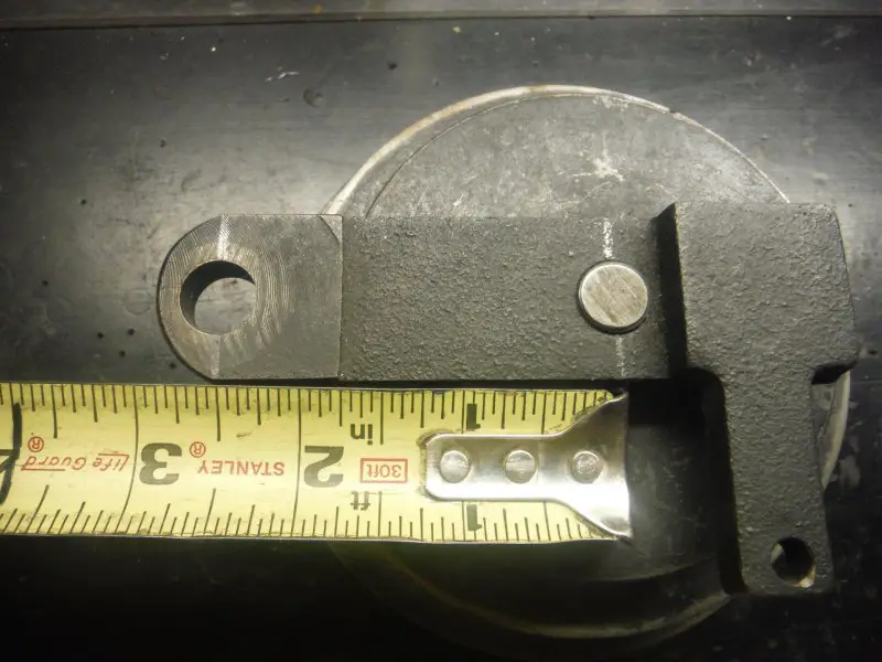

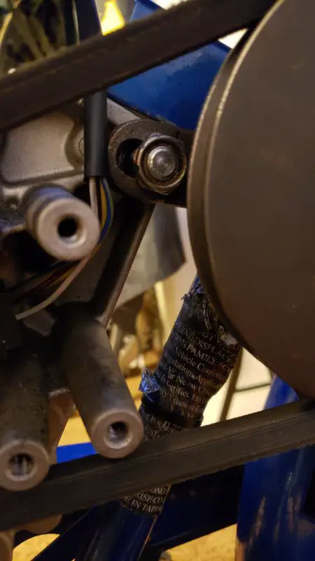

I see your clutch arm is slotted. Never seen one like that.
The clutch arm needs movement. Grease bushings,Tighten the nut down then back off about 1/16 of a turn this allows the arm to move. If clutch arm bolt holes spacing is like mine in the Pic your clutch arm is fine, If the bolt holes spacing is different. You need another clutch arm. Paul will have one for you. Front belt should not rub. You should have a least 1/8" clearance. When belts are tight there should only be 1" play - Movement up 1/2" and down 1/2" - total 1" movement.

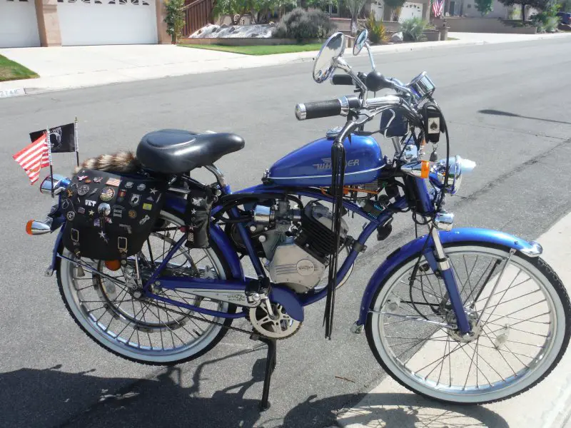

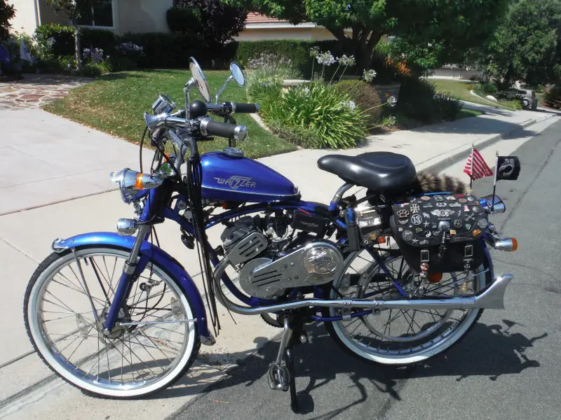

Fire er up and ride
My bike looked just like yours when she was new.
I put on Worksman Cycles drum brake wheels
I run a NE-5 Westman Cyl, I Did the valve and piston fit my self.
Ralph Passed away in Jan 2020 All of Woodstock whizzer Works sales have stopped and will not be available. He has hundreds of Cylinders in his shop. Ralph willed everything to his ex wife and she is gonna auction everything off someday. I keep waiting for the cyl to surface some where. I will buy a couple more if I ever see them again
Over the years I kept on adding to my bikes pin collection.
My Gal says I buy my Whizzer more jewelry than I buy for her

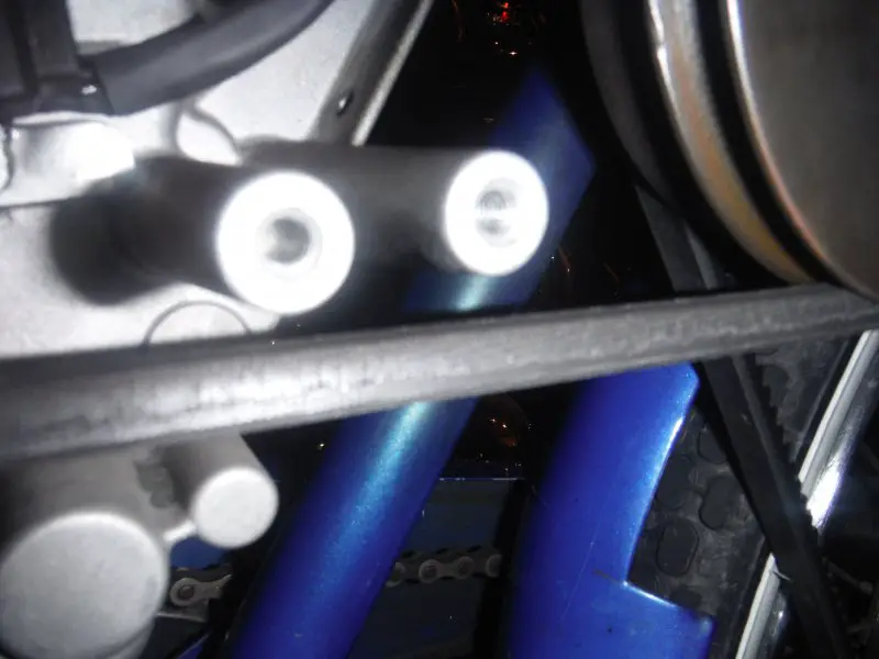

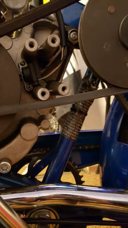

just went through the belt thread and still can't seem to get the belt off of the "shafts" that the belt cover mounts to. It seems the tension from the new spring is pulling the pulley upwards, forcing the belt to rub on the lower shafts. is it just a matter of break in?

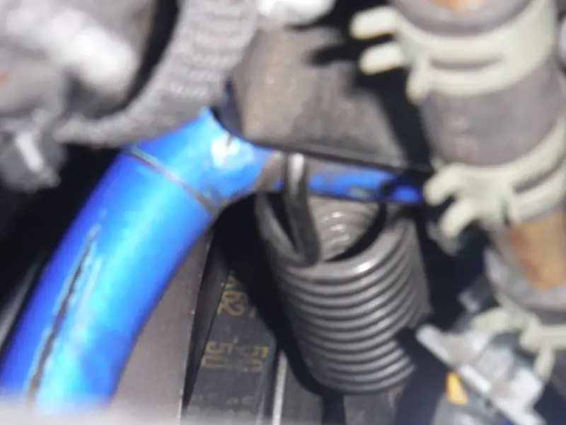

Did you hook the spring where the luggage rack mounts, Under the luggage rack mounting bracket to the frame support cross bar?
wrench
Aug 20, 2019
641
751
93
So Cal
Cruzzer changed a few things from when it was owned by Whizzer.
Cruzzer mounts their spring different and I'm wondering if you got a shorter spring? My spring has 11 coils how many coils dose your spring have?

Well that just may be it, I'm counting 10 coils. I'm a pretty dangerous garage mechanic, but after a week of fiddling couldnt find a happy position....was starting to question my sanity. It definitely seems it's just barely too short.
