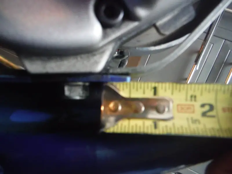

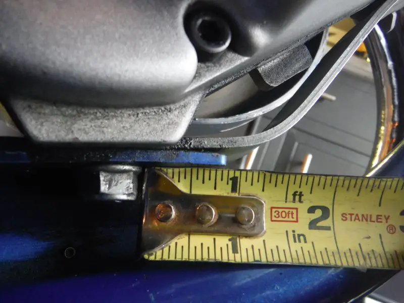

Only other thing I can think of, is you motor is not quite positioned right Can you make heads or tails out of my motor mount pic?
I measured from front of mount to mounting bolt 7/8" and measured from front of mount to case front edge 1/2"

When you find the correct mounting position Mark your mounts to frame and mounts to engine with sharpie marker Just make a small mark, So if you ever take the motor out again Everything will line back up just as it was before when ya put the motor back in.

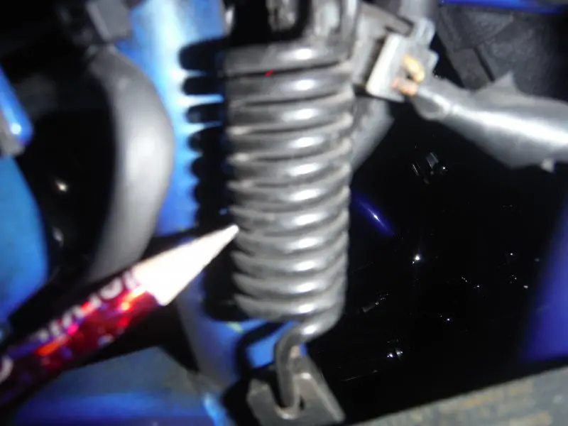

Here is a pic of my spring so you can count the coils and compare to your springs coils
My spring counts 11 but can be counted as 12

Thanks, its definitely too short. I'll reach out to Paul and see if he has a longer one. I had a good idea of positioning based off of previous marks (since the bike is close to new/un adjusted). Thank you so much for all your input on this, I'm trying to not half ass this due to scarcity of parts/trying to get the longest life & enjoyment out of her as possible. I'm glad being careful hasn't led to any undue harm to it yet.

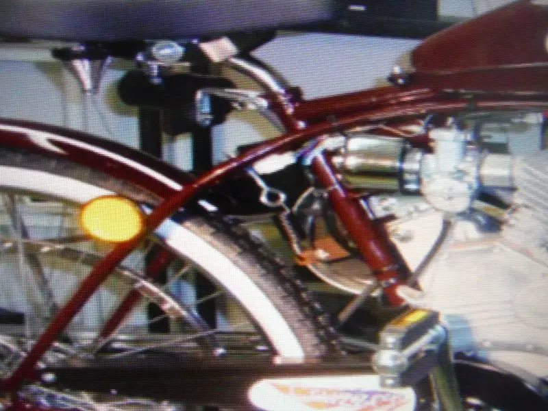

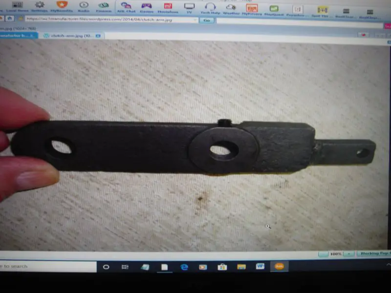

Pic of a Cruzzer clutch arm

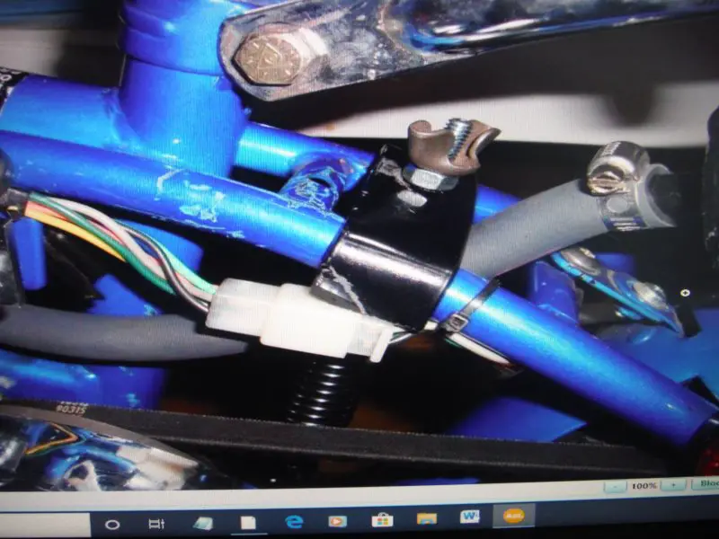

Pic of the Cruzzer clutch arm with an eye bolt on a Whizzer (WRONG)
Pic of the Cruzzer with a Cruzzer clutch arm and eye bolt. See how Taiwan uses a short rear fender so the clutch arm don't hit. Also was cheaper for Taiwan cause they didn't have to notch the rear fender for the belt.
Just thought you might need this info so ya don't buy something ya don't need
