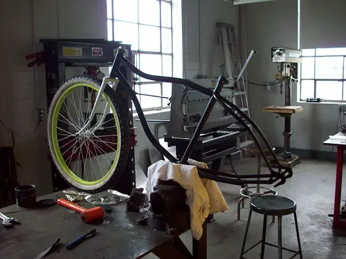

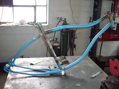

    Took it up to the shop and flipped the upper tube to make room for the motor, yours truly acting stupid.
    [​IMG]

    Very nice switch, I like the way that top tube looks and flows with the rest of the bike.

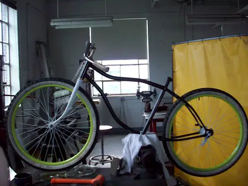

    Stripped the bike down for paint today.
    [​IMG]

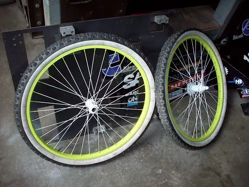

    Wheels
    [​IMG]

    [​IMG]
    Flipped the bars back to normal, I dont like the Cafe` style
    [​IMG]

    the frame has an interesting style for sure. I always cringe when re-welding bike tubes but they can withstand a lot of use if done well.

    Great idea. Vintage ladies cruisers are always priced lower and the flipped tube makes a very unique frame.
    You should apply for a job in the design department at General Motors.

    Mower Man Chris got me in to this as well. Gus' (switch) bike was originally a heap that I found stashed away in the shed of a house I rented a while back. Chris gave me an old cruiser of his that his motor was on at first and then I gave this one to Switch.
    Chris, Gus and I are all part of an SAE Baja team that builds off-road vehicles using 4130 tubing ranging in wall thickness from .065 to .035. In other words, we have some experience welding thin wall tubing.
    Gus welded it with a Lincoln TIG and ER70-S6 filler wire. It should be just as strong if not stronger than the original brazing.

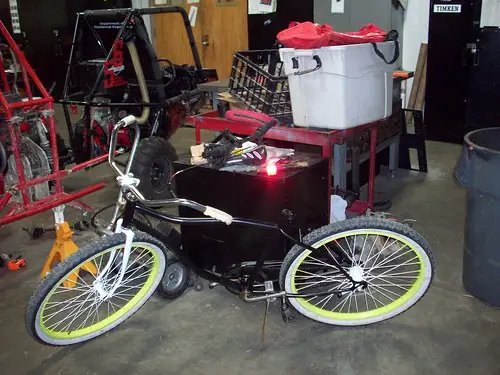

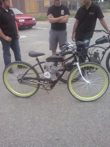

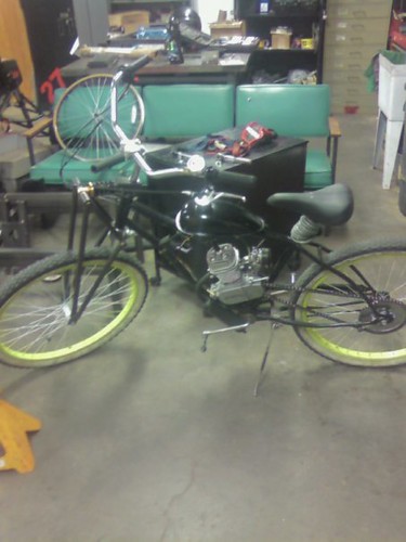

    Got the motor on today. Rides great, best money I've ever spent.

    where did u purchase your motor? Great job on the bike! I like it a lot. Hope its as much fun riding as the build was.

    eBay. It was the STINGER kit or something like that. $160 shipped and I'm very happy with the ride. Easy as **** to put in too.

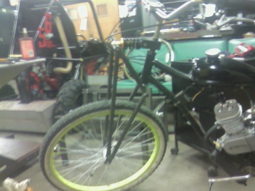

    New custom made Springer front end.
    [​IMG]
    [​IMG]

    nice set of forks!! keep it up

    nice. how do they ride?
