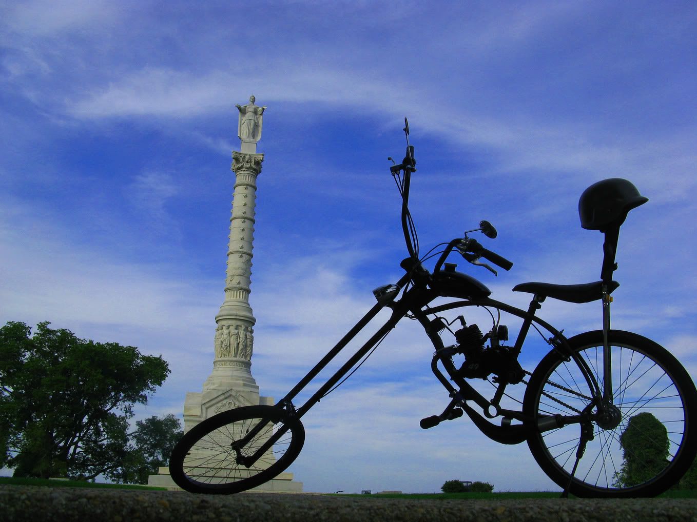

i enjoy photography. In this picture i tried to grab a couple things to keep the theme military related. These were taken at Yorktown battlefields. The statue in the background dates back a hundred years ago. (interesting fact: It was hit by lightning back in 1903 (if i remember correctly) and it blew the arms and head off)
I have the chopper, which is mil. theme, and i put the helmet on the back sissy bar in a silhouette. it reminded me of the rifle in the ground at the site of a fallen soldier.
Also the colors are pretty too, haha :D

i have had the tame, bolt together bikes before. i wanted to take it a step further with this build. When i do things, i really hate hate HATE to have to do them twice because of an error. for the first 2 months or so i researched and designed before i started collecting parts.

Hey dude thats nice. But my question is. Is the reason why you took off the pedals was cause they wouldnt turn with the engine, and the engine wouldnt fit because of the crank????
Thats the partial reason why I have decided to get rid of my pedals. My engine has an electric start with a pull start back up. I just hate all the damn wires!!!! lol...way way WAY too many!

i just got rid of mine because i was going for a clean minichopper bike look, not a mini chopper bicycle look :p
plus, on long rides, i like to have my feet even with each other.... im just OCD like that :D

word buddy! i like it, super long fork looks pretty americana if you ask a canadian.

One thing i keep procrastinating is plugging up the bottom bracket hole. really shouldnt be hard to find a rubber plug or something haha.

this is exactly what i want for my bike haha. How did you come across those fork fab or did you find them. If fab from what originally and if not were did you get them?

I built the forks out of an old 1" threaded steer tube from another fork, and welded it up with 1.5" DOM steel tubing.
