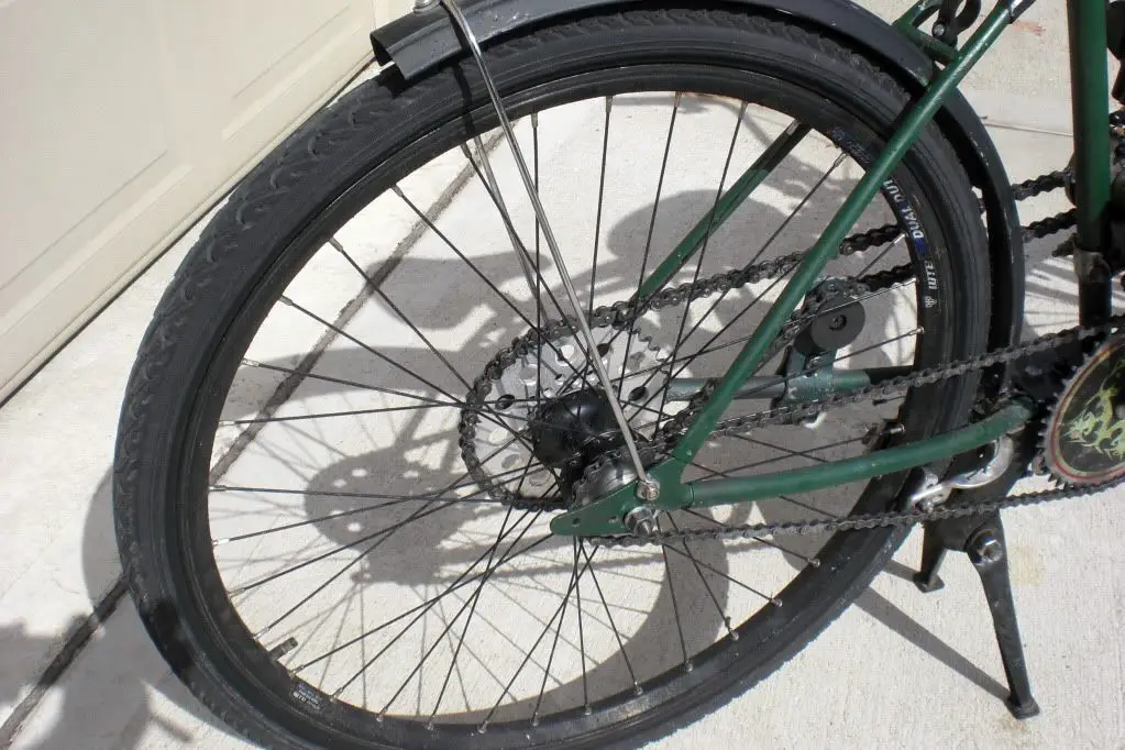

Hey guys just wanted to show off my Micargi build which will be holding a 49cc 4 stroke with a 4G T belt. Right now its just for looks because I got to find a good way to grind down the front engine mount and go through and thread lock all the bolts and grease the bearings better add a gas tank chain and hook up my light system.
With these mag rims is there any good way to add a disc brake on the rear because at the moment all I got is front disc brake and no back brakes so that wont cut it. So what are my options?

Thanks think ill give that a shot.
Right now my build is on hold waiting to get my engine mounts from ghettobikes seeming how I was not to happy with the way I was going with.

there are disc sprocket adapters, but they don't have adjustment built in. I've had a struggle just aligning the sprocket inboard. technically you can mount the rotor and sprocket with these. I have one from MZ Parts off ebay. most are similiar.
