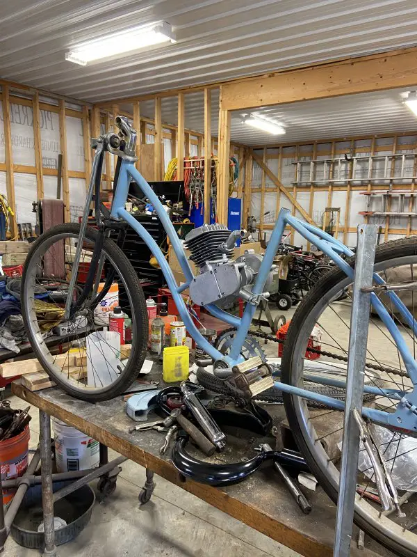

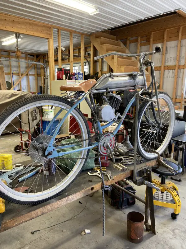

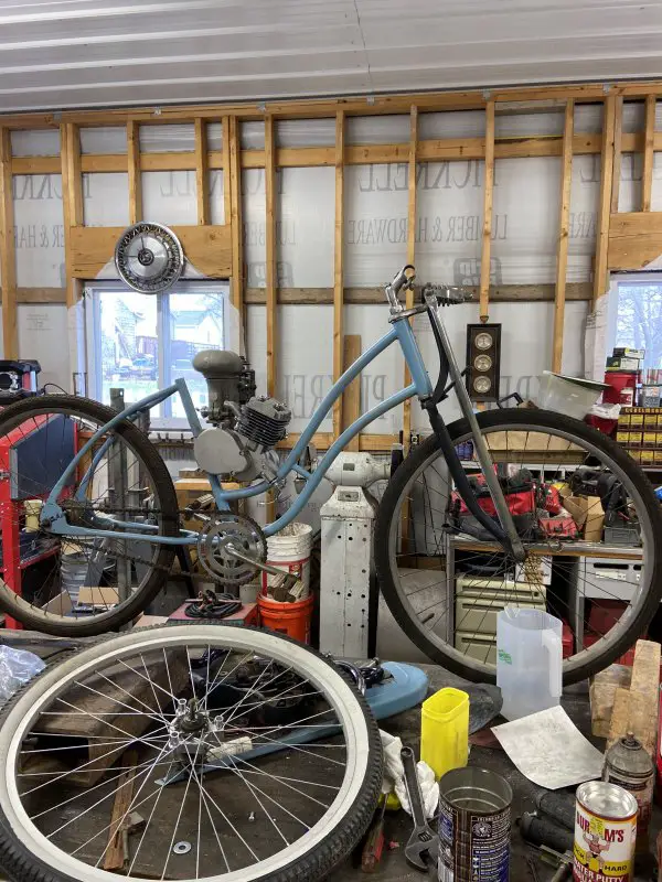

I’ve had this girls bike around for years. It was my older sisters, she got it new for Christmas in 1959, but she didn’t want it any more and told me to scrap it. I have better ideas for it ! I have a little China girl 2 stroke that I wasn’t using so I decided to build another board tracker. I’ll post more pics as I go along .

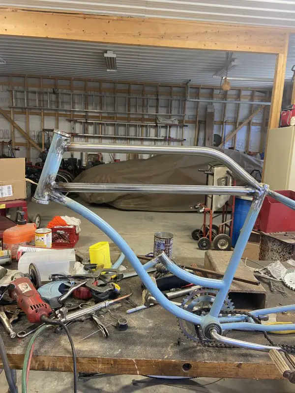

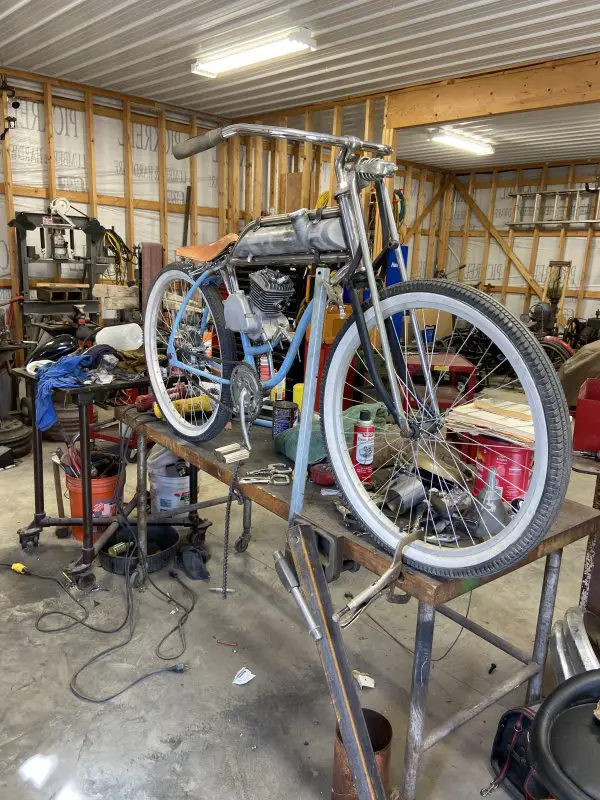

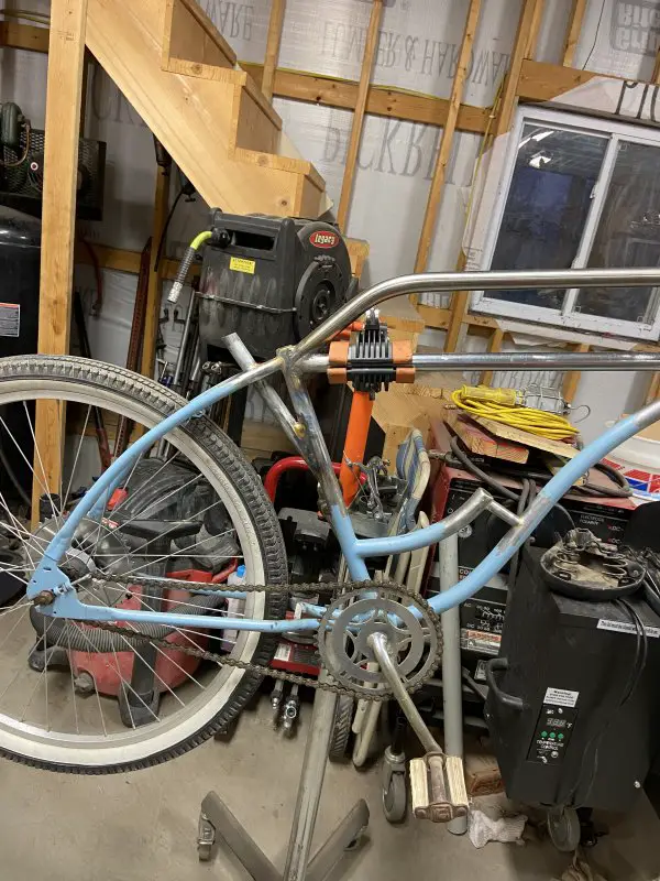

Started roughing in the frame last night and tweaked it a little this morning. I need to stop at the scrap yard tomorrow and look for some more scraps to build with. Also need to pick up some 3” tubing to build a fuel tank.
I originally was going to make this one a side car build, but decided to use a bunch of Huffy cruiser frames I have stockpiled to build that from. Also the next build will have a 4 stroke Honda .

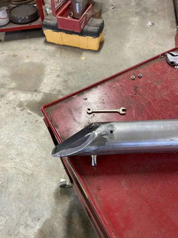

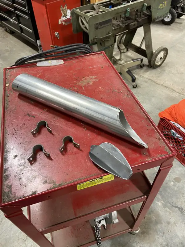

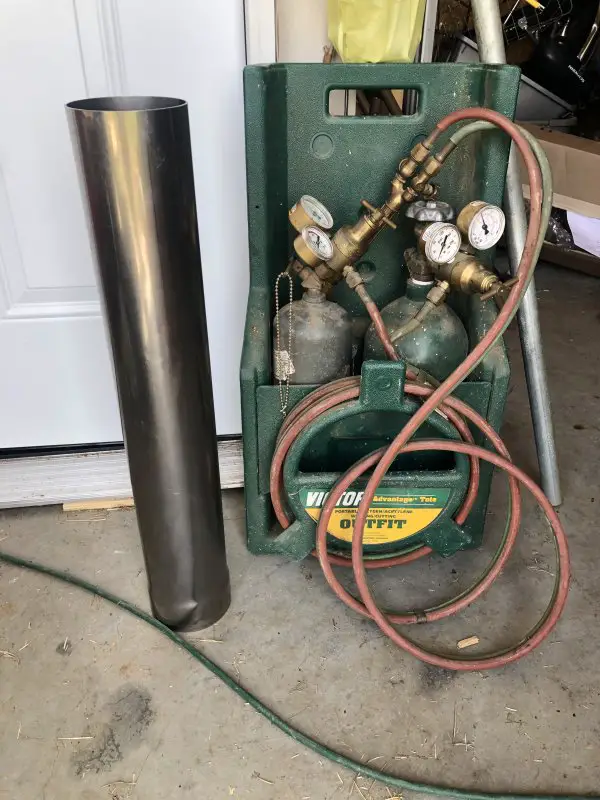

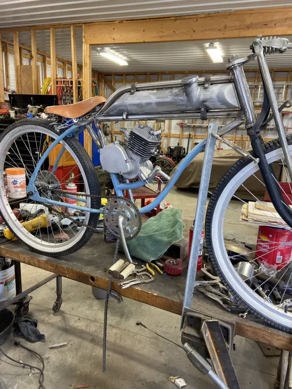

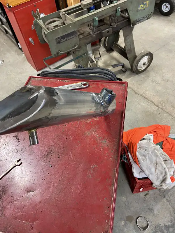

Well I have the tubing all cut for the gas tank, just have to braze in the mounting nuts on the inside. Then add the tank filler neck and outlet pipe and I can weld the end caps on it.
I plugged the old seat post and added a new post further back and at an angle to get the seat lower and behind the gas tank. Getting a little closer.

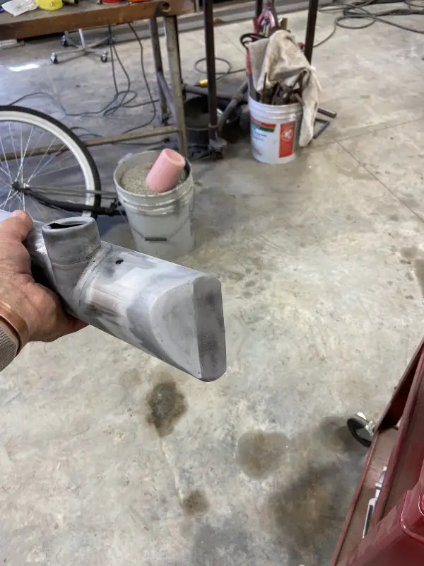

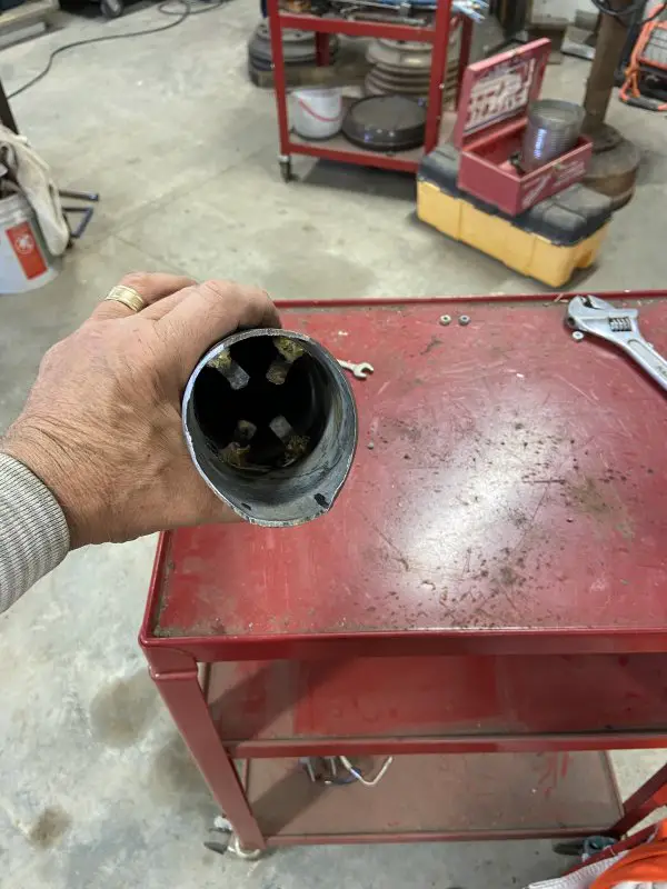

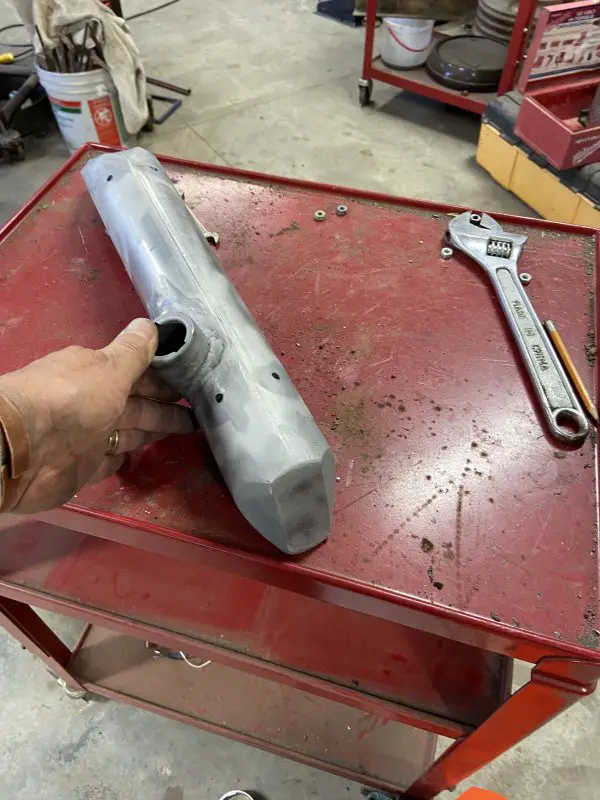

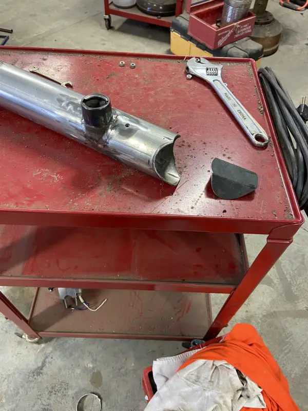

Well as promised, here some more pics of the fuel tank. I just need to glass bead the inside a little, then weld on the last end cap. A little sanding, a little bondo, then tank sealer, then paint .
