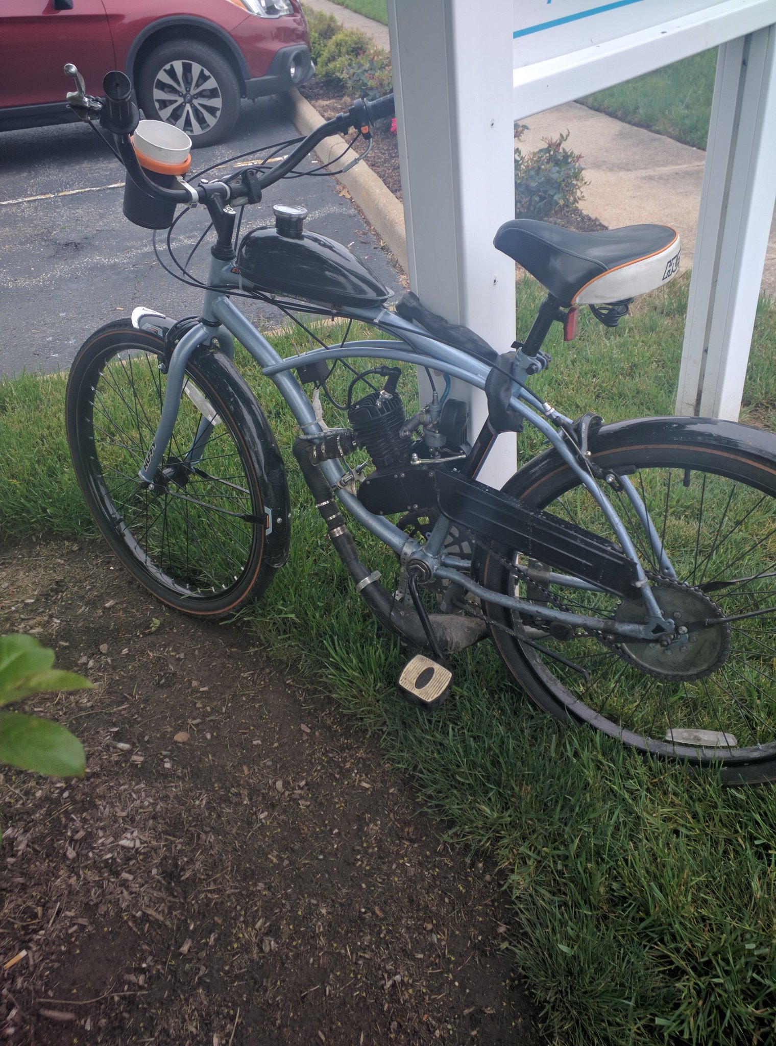

Its been a while sense I have last updated my progress :D
I just wanted to keep everyone following some news. Everything seems to be doing pretty well I have successfully jetted my carb so I can WOT . I am topping out at around 28-30mph which is good. BUt Of course I am wanting more :D
But i do have a problem or two. I have a jumping feel, Another way to describe it. When im riding, It feels like the bike jerks. It doesnt happen all the time but I have noticed it.
I have also been hearing a " scratching " noise coming from the motor I dont hear it all the time but Occasionally i do. I have my thoughts but nothing i know for sure.
Also when i ride down hills my bike use to pick up speed and continue to pick up speed. Now it seems to be capping at a certain RPM and doesnt pick up any more. It gets louder than normal while going down inclines also. So I have been letting off the gas and using 1/2" throttle to just cruise down them. I dont want to put any unnecessary wear on the engine. This HIGH RPM isnt normal for it. I have hit speeds of 36+ going down hills now Just reaching 31 or so and topping out.
Thanks for any input here is a pic after a rainy ride.

Fuel mix is not the problem, jet size is what controls the mixture at high speed. Sometimes a carburetor will not respond to jetting, I have one that just flattens out at around 28 to 29 mph, I changed jet size with no improvement. I changed carburetors and got 31 mph with the same jet size of the other carb. Another problem could be the air filter, a good high flow filter will help at high rpm. The type available from SBP is what I run.
Greg58
May 1, 2011
5,363
2,590
66
Newnan,Georgia
Its best to go a little rich than lean, if the engine seems to be getting hotter than normal its probably lean. When jetting mine I go a little to the rich side, I like my plug to be a little darker brown.
