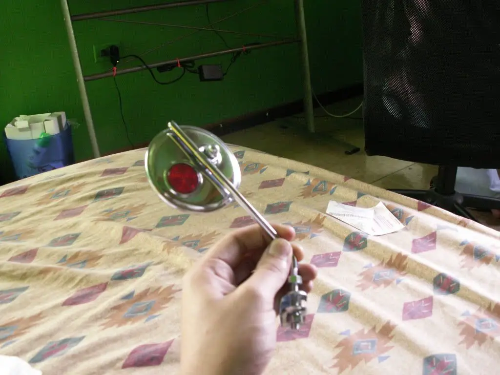

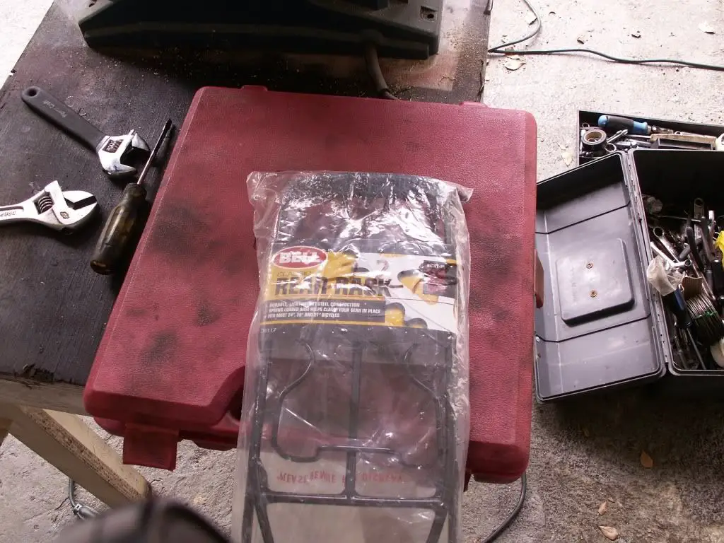

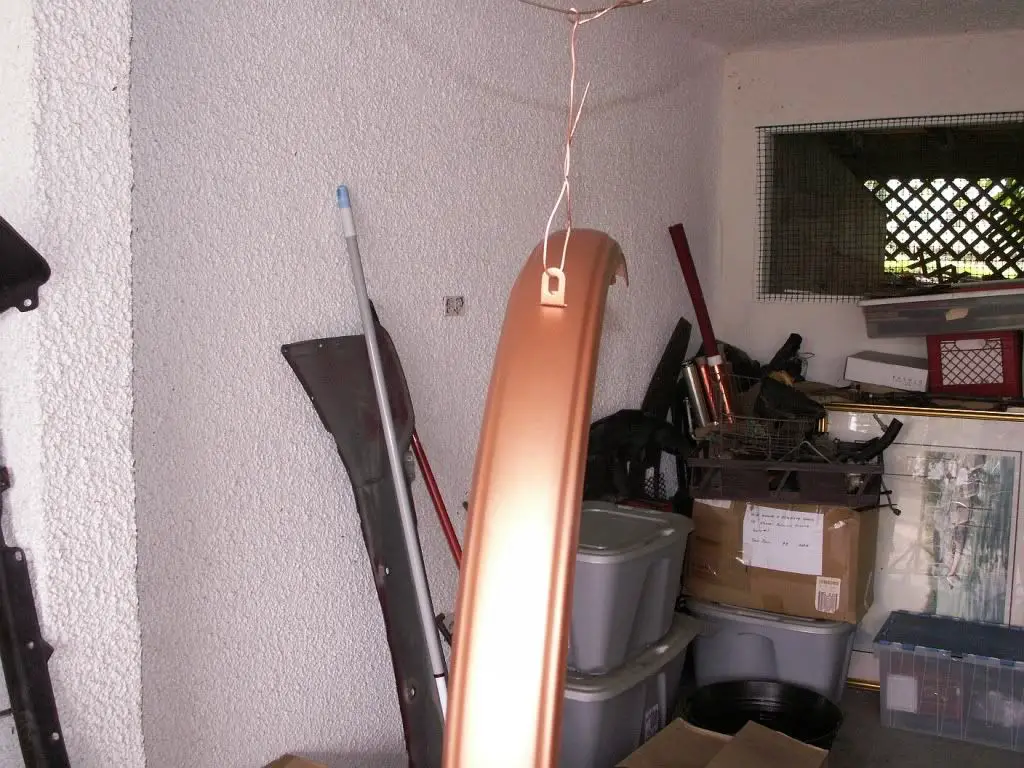

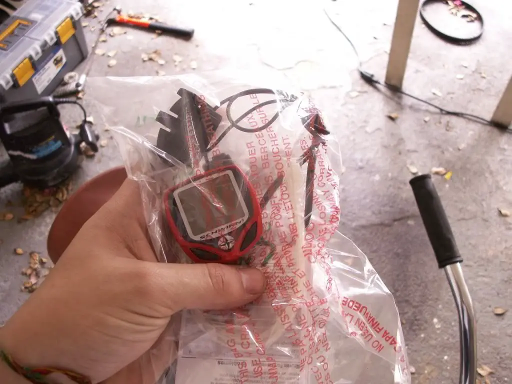

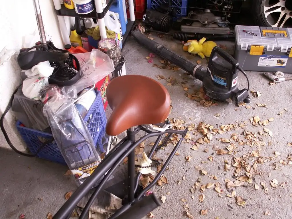

    Ok guys heres the preview: the bike is a new cranbrook bought at wallyworld, engine is a black slant kit from BGF.

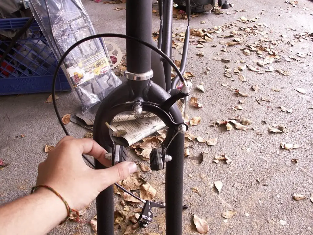

    It will have the coaster brake, as well as front and rear brakes, speedometer, rear view mirrors on both sides, fenders, rear rack for cargo, brown leather seat, custom expansion chamber, and some nice slick tires if I can find them.
    Please comment on whatever you see wrong/like. Im super excited with my first build.
    Cost so far:
    Cranbrook $99
    Slant Engine kit $150 shipped
    Expansion was $65 locally
    Seat $30

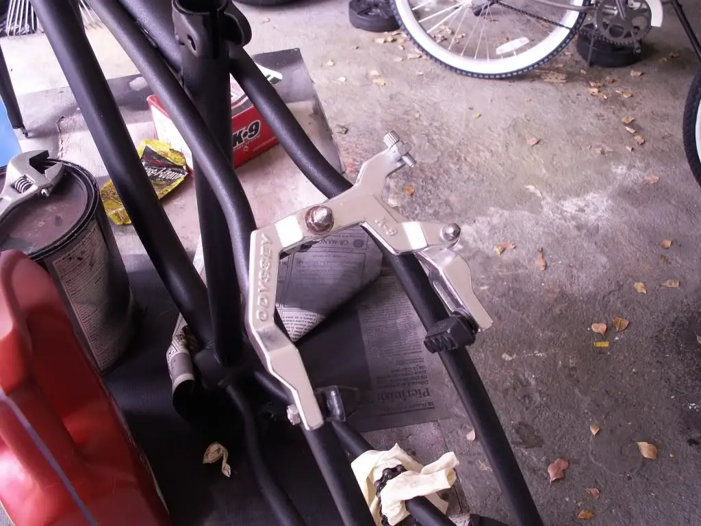

    Basket $20
    Rear Brakes $15 is that ok?
    Fron brakes $12
    Mirrors $10 for both
    Red Bearing Grease $3
    Bed Liner paint $8.99
    [​IMG]
    [​IMG]
    [​IMG]
    [​IMG]
    [​IMG]

    While I get mu dual pull handle, were should I mount my brake, front or rear?

    Until you get the dual pull handle, if you're only going to run one brake handle, I'd put it on the front, and make sure you're using it and your coaster to stop under normal conditions.
