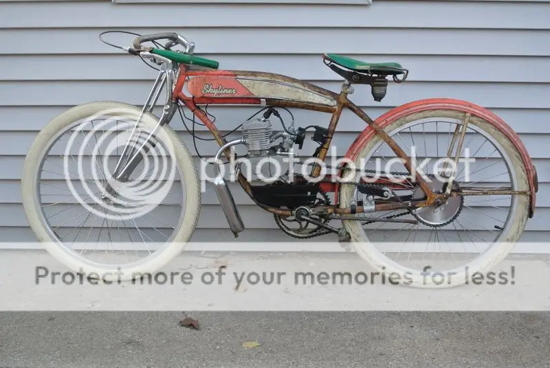

Finally found this forum. Thank you all for your great builds and inspiration!
I am 3 weeks into this build and getting many great ideas by browsing the forum. Here's what I have put together so far:
-1936 Roadmaster Bent Double Bar Frame w/ original forks
-Prewar Dogleg Crank w/ 22tooth chain ring for side plate clearance
-New departure wartime blackouts (8tooth rear sprocket) laced into 12 gauge heavyweights
-Torrington Handlebars
-48cc Chinagirl
to do:
carb & shorter manifold
rear driving sprocket
repop coke bottles on a new throttle
seat
tires (clay brick)
truckd

Thank you all so much. I'm looking forward to the influx of fresh ideas and inspirations for this build. I built up a motorbike in a postwar schwinn DX frame this fall to learn from, and stumbled across this Roadmaster frame / forks hanging in a junk shop in central Washington state. Just couldn't pass it up!

That is looking pretty cool..There is a guy on ebay from California that does custom gas tanks specific for these old frames it would fit right between the cross bars he does an awesome job and price is very reasonable

Fixed an airleak this weekend. Runs so much better! Fine tuning. Added some nice motorcycle coke bottle grips.
Ordered a clutch plate mounted chain tensioner from the member here selling on ebay. (probably paint it black to match the china girl!
Looking for black peaked fenders and a front disc brake. Enjoying finding some classy finishing touches!
