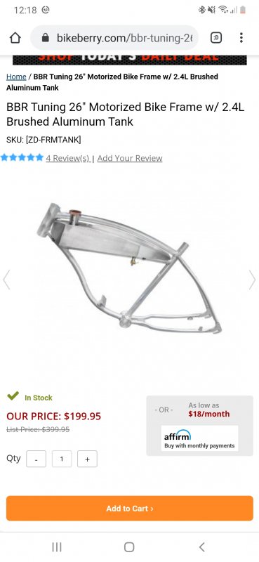

I've decided it's time I make my first build, and due to lack of money trying to make it look as good as possible for as cheap as possible. I have decided my MB will be based around the Schwinn panther flat bar frame copy used by a lot of people on this forum. This I have already ordered , however I have nothing else set in stone. 80cc China engines seem common but I don't know much about them. I've seen kits for disk brakes but again, have no idea how reliable they are.

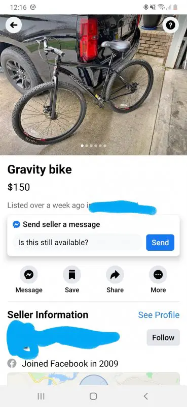

I also have attached a picture of a Facebook marketplace bike that might be good to steal parts from.

Big tick on the frame/tank choice for your boardie project. Thumbs down on that parts bike though. There's nowt on there to donate to the project's frame save the wheels/tyres - if they're even usable. Motorized builds generally utilize 26" wheels with heavier gauge 11/12 gauge spokes. Expecting to pedal a motorized bicycle very much defeats the object, so your boardie will be a single speeder, therefore a multi speed cassette style rear hub needn't be on your shopping list. Maybe a front disc brake - not my preferred choice on a period style vintage bike - is something you'd want. Sturmey Archer do a very nice front drum brake worth considering.
Do the job right and bin the rear wheel's rag joint type sprocket fixings supplied in every bicycle motorizing kit and opt instead for a rear coaster braked wheel onto which you should definitely fit a cnc'd rear sprocket hub adapter. That's one of the best decisions I'm happy to make on your behalf. Thank me later.
Other than having reservations about how tight you can screw down the budget on this type of project and still end up with something you'll be pleased to own/ride, I'm looking forward to following along with this build thread. If you're anything like me, once you take delivery of the Panther frame/tank, you'll realize it's quality deserves the kind of build that doesn't rely on using someone else's cast off bits and pieces. Start budgeting.

Thank you for your input! I appreciate the information and have now added a couple parts to my list and trashed the parts bike idea.

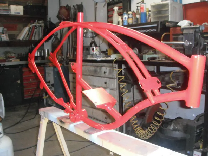

Starting off with a new, bare metal tank and frame makes painting a build like this so much easier than having to tear down, strip, de-gunk and probably de-rust a used donor frame. Little or no masking involved. However, other than deciding on the colour, I wouldn't recommend doing any frame painting till you've built the bike, enjoyed some test riding and carried out the necessary modifications or adjustments you'll definitely have to make. There's plenty scope for scratching/scuffing a new paint job during the build process. Build-up the bike first, then tear it apart for painting. It'll only take an hour to unbolt everything - time well spent.
As far as the actual painting itself is concerned, I exclusively use aerosol paints (rattle cans) for both the primer and top coats. To avoid runs and the dreaded 'orange peel' look, never aim for full coverage using a single coat of paint. 3-4 light coats with light rubbing-down between coats using 1200 grit wet'n'dry paper - used wet with a drop of washing-up liquid soap added to the bowl of water - assures a smooth, shiny finish. I also tend to seal the finished top coat, along with any added decals or pin-striping, beneath sprayed clear lacquer. My debut build, the Indian boardie tribute, and my other bikes were painted in my garage. Parts such as the frame, tank and dismantled fork components were hung on bent wires suspended from the rafters. For already assembled wheel rims, I mask spokes using split drinking straws (I now know you can buy plastic spoke covers - doh!).

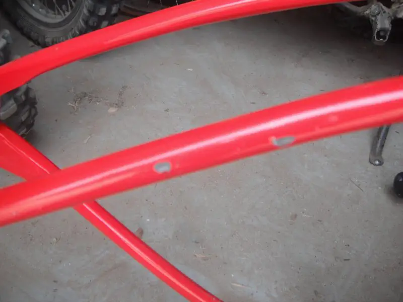

Is there a brand of paint you like Pete? I'm using Rustoleum and not happy. With light coats, color sanding, and heat soaking the can in hot water until the label got loose I was able to lay down a lovely coat.
But it's just too soft. This led to baking experiments and 150 degrees for a couple of days did make a difference in that I can dry sand it and get powder instead of a piece of gummed up sandpaper. It's as hard as it's gonna get.
But it's still too soft.
Had it on the floor when I bumped it over with my leg. It took a 45 degree tip entirely under it's own weight, landed against a hard plastic handle, and did this.
It chipped right back to the Rustoleum Self Etching primer so I'm OK with those cans. But I won't buy another can of their enamel ever again.
Is there some specific brand you like?
Rust oleum is good but the downside is it needs weeks to really dry and bond. I too had problems. Should also light sand primer before top coats. There are easier options for sure.

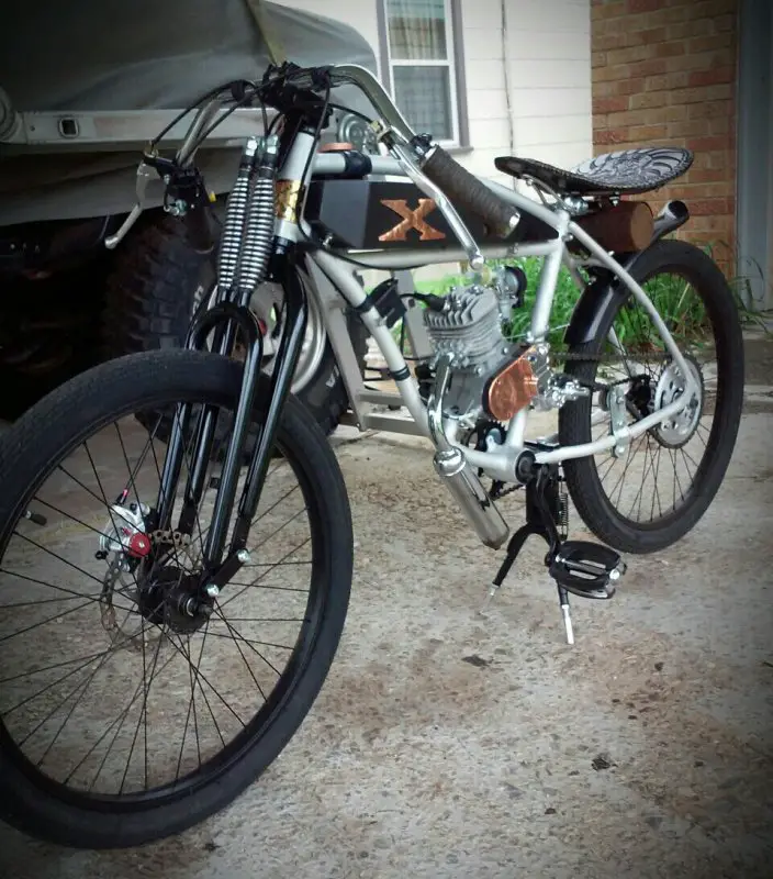

The bare metal look always works a treat on vintage style boardie bikes. Food for thought - and it'll definitely save you some time and help with your budget. For inspiration, check out Rick's (Indian22) latest e-powered V-twin build in his Old Guys Simplex thread.
Lander I'm following along on your build and see you've found some excellent advice and are acting on it. $$ are a part of this but Pete got it right & you recognize you are invested enough that it makes good sense to do it right as dollars are available. Helping others is always noble & in this case of helping your friend build a bike you benefit from hands on experience. The forum is here to help and encourage. Those who've built bikes for years can help you avoid common mistakes made in the past and each one of these mistakes avoided save you time and money, also it's easy to become discouraged along the way. We've been there and done that. Share photos and reveal plans prior to spending your money on parts or fabrication that others can warn you off of. We each don't know it all but as a complete forum we've encountered a good bit of it.
Both Pete and myself have used the exact frame and tank you've selected to build motorized bikes & though both of us selected board track style and 66cc China girl motors they are both quite distinct. I really like the way they both turned out his a beautiful red and mine definitely not. So I'm looking forward to yours putting us to shame. I love a great build!
