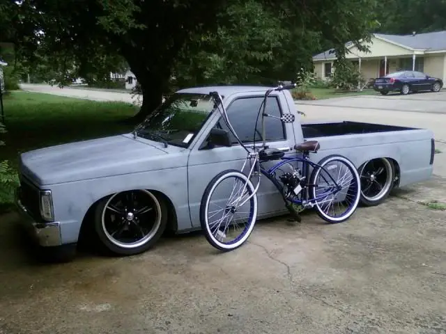

    This is my Cranbrook I've been parting together..
    Before the chopping block

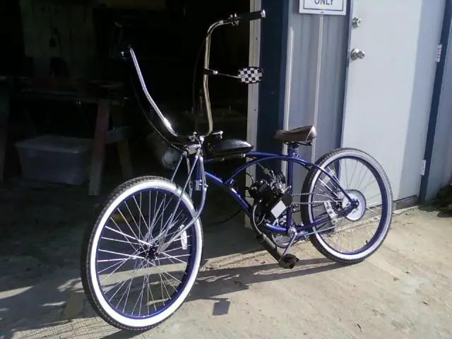

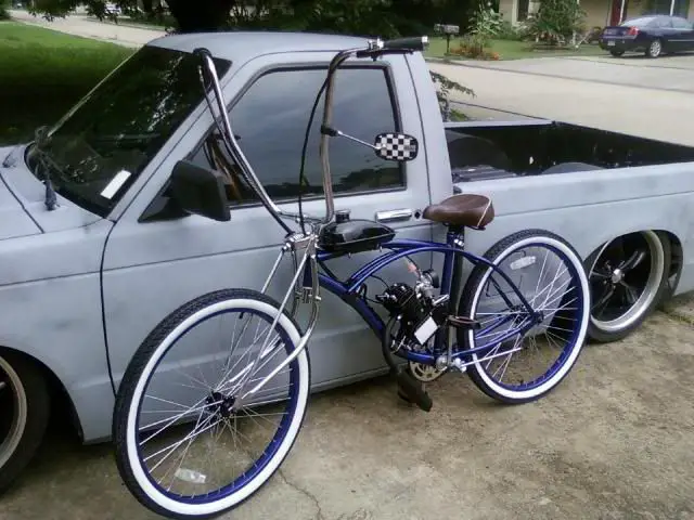

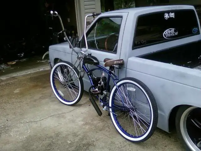

    Almost done..
    [​IMG]

    Lookin' good SW

    Wow that is some ape hanger! how tall is that?usflg

    I was thinking the same thing, those bars are as tall as the whole bike if not taller.
