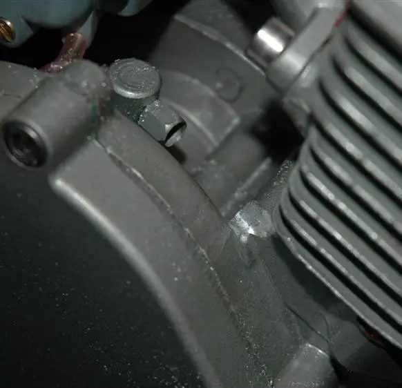

Does everybody have to grind this relief for the clutch cable?

Dang no heat! I can barley stand the winter tenp here in San Diego, can't imagine what it's like up north. I ground for clearance there on all of the "80cc" bikes I've put together so far, about 5/16". By the way very nice work on the clamp I really miss having access to a Mill.

i never had to grind away to make the clutch cable fit, but i've had some pretty poorly aligned cables in the past.
i solved it by getting a "brake noodle" from the bike shop. you take off the adjuster, and drill out a couple of threads in the keeper that screws into the engine, and push the noodle in. that way you can run your throttle and clutch cables together all the way, and it also eases the tension on the clutch pull. all for about 3 bucks and 2 minutes worth of work.
