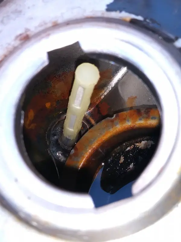

I lose engine power while in motion i just pull the fuel line right away before I stop to see if that is the reason my engine is not running. the fuel lines and fittings are so small and the volume tough to keep flowing, that is how I test my system for a clogged fuel filter. usually the tank strainer gets clogged and kills my flow. just rode 80 mile round trip today 40 miles on 1.8 quarts to work 1.8 qts to get home. runs amazing! But could run better! cruises good at 30to 40 mph

I have had gas tanks with rust inside in kits, a old trick I've used several times to clean them is simple, I add a couple hands full of marble size gravel with diesel or kerosene add shake the tank vigorously till the inside looks good. I did this to the tank on my 50 years ago.

Hey Javey,
Save yourself from the problem. Throw the "Tank Strainer" away. You don't need it. Use the transparent external inline fuel filter.

Hey Javey,

the tank strainer keeps the dirt in the tank not my fuel filters I like it that way. the new tank is dirty as like india. Also the fitting in the tank is a male so need the female style valve, but all good easy to clean and get going again, the strainer is good to me. Thanks anyway!
