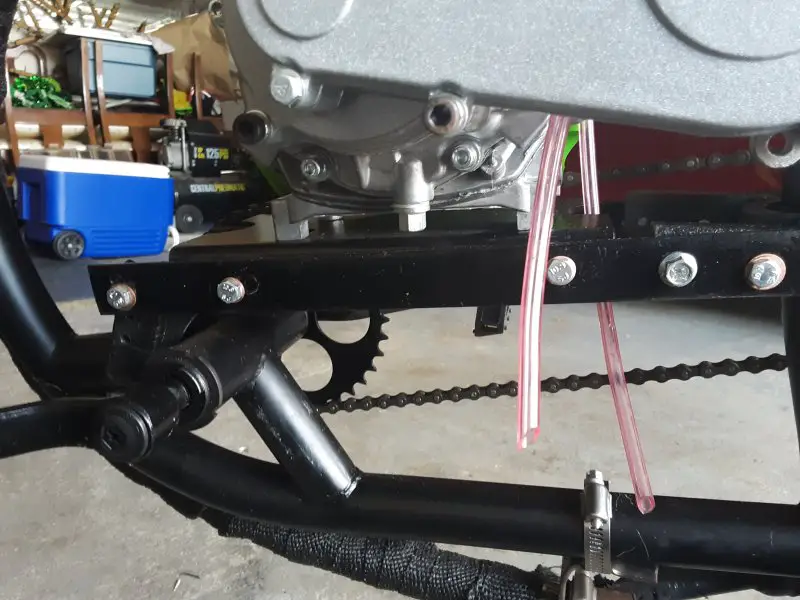

No, it came with the fuel hose, but it is identical. And of course, fix one problem another pops up. I took it out for a short ride last night, ended up breaking 6 spokes on it, the ones near the adapter. Not sure how exactly it happened, so now I'm gonna have to replace with beefier ones.
