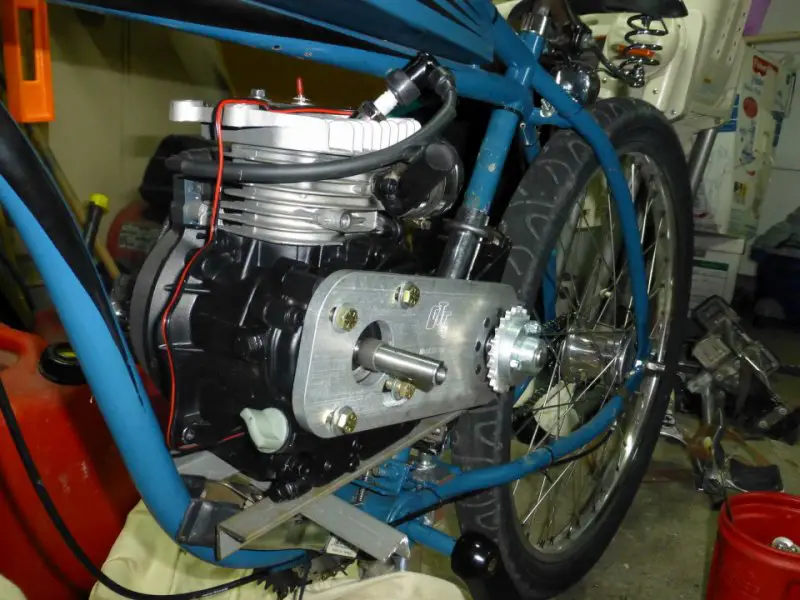

That mount is a better quality mount versus the standard 49cc mount sent in the kit. The mount is standard for the kit on the
"Death Row Preditor 212cc." You might want to check to see how the mounting holes line up and you will probably have to
drill them? I consider the mounts on 79cc and 212cc kits are just temporary mounts that are available to try out on a bike.
A drilled plate welded would be the best choice for a permanent engine mounting solution on both of the engines. There
is another mount available for the Predators which the fellas are using: Vertical Mount
Dennis
That actually looks like a really good one, and would probably fit very nicely on my bike. I'll keep that in mind for the future. I'm hoping to get the bike up and running tomorrow and will take some pics, although I started a thread in stretch choppers/cruisers sub and that one seems abandoned.
  • Like
Reactions: EZL
One gripe I had with the mount was that the stainless allen bolts were excessively long in length and as far as MBRebel's steel channel
that is about 13" long, the slots weren't wide enough for the stainelss allen bolts. The CNC mount was ok and make sure it fits good on
the front mount and the seat tube. My seat tube sits at a larger angle than most tubes and I had to grind the metal away to make sure
it fits correctly but I'm still not impressed with these mounts and the others for the 49cc engines.

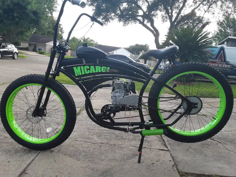

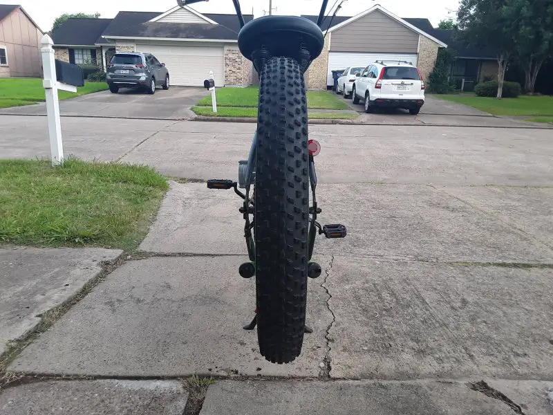

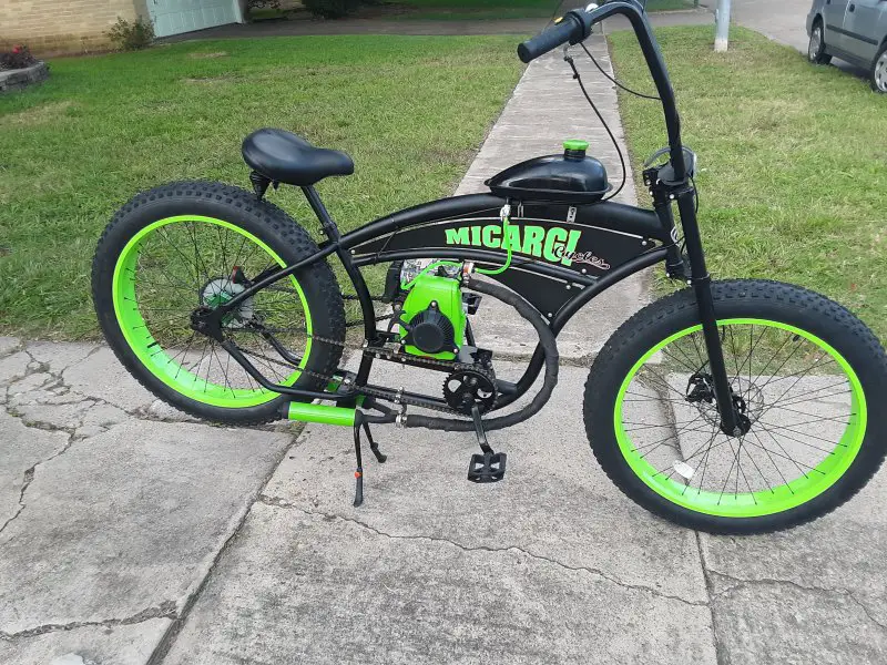

Here it is, finally got to take it for a spin. The third picture was to show the exhaust from the back.View attachment 105252View attachment 105253View attachment 105254
Nice job on the bike! (^) I don't recognize the Micargi frame? I have a 49cc on 26" Micargi Touch bike and it's been real reliable.
I've got the "Ghost Racer" transmission on it and have messed with different sprockets for it. The ride is terrible since it doesn't
have a suspension fork on the front. I might change it since a suspension fork made a huge difference on the Sixthreezero bike.
When the weather was hot in the Summer I had all kinds of problems with the engine. I found that the oil was breaking down
from the heat and switched to Pennzoil Platinum 5w30 Synthetic oil and that cured the problem. The non-synthetic oils are
obsolete on these engines nowadays since they have to work harder and run hotter. I think you have plenty of room for a 79cc
engine. The Micargi frames remind me of the old-school heavy framed bikes. I'll have to get some pictures out on the two bikes
I built. I had a chance to sell the little 49cc but decided not to just in case the big one goes down and I needed cheap
transportation. My 49cc has well over 3,000 miles on it and I haven't had to do much on the engine.
Dennis

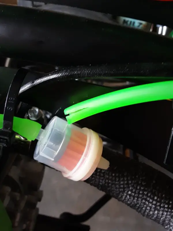

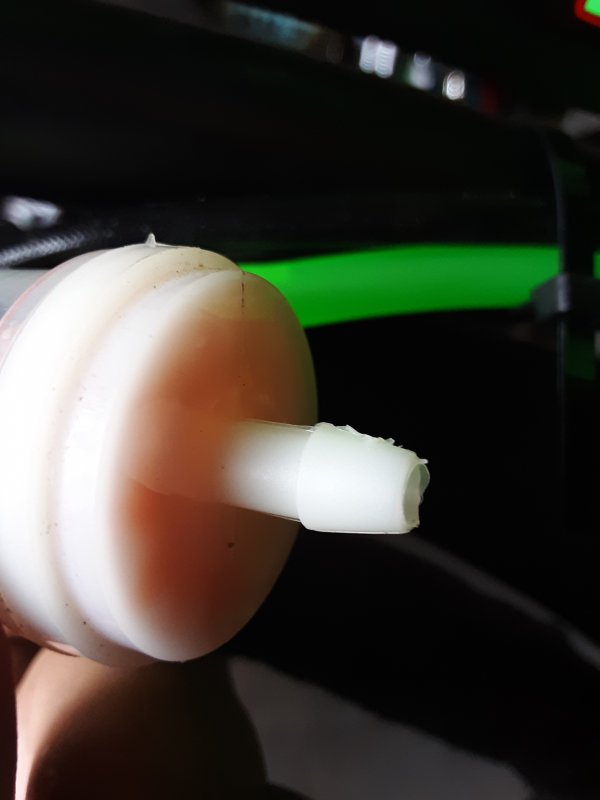

Since you mentioned the fuel line, for some reason the end that connects the tank to the inline filter is splitting. I bought the fuel line off Amazon so i have no idea what is the cause. It is literally only the end that the filter plugs into and I just put a fresh section on it today, already split. So it has happened twice now, only that end so i don't think the line is being melted. Any clues?
I take it the line is a plastic flexible line? I tried some of the blue clear plastic line and found that when I put the bike in storage
and in the Spring the line was stiff like a hard fuel line. That stuff had to come off the bike and I went with automotive fuel line
that does not do that. I was wondering if you were running alcohol mixed fuel? Alcohol will soften the plastic and dry the fuel
line out even with non-blended alcohol fuel. Never use use alcohol blended fuel on motorized bikes.
I use the automotive fuel line and it has never bothered with the engines. Most of the problems on the bikes is that the carburetor
inlet is small, 1/8" and if a fella uses the small plastic line it gets stretched and eventually can split. I try to use the 5/16" fuel line
and have to adapt it down to 1/8" line with a adapter. That was a problem on the stock Preditor 212cc engine carburetor since
it uses a small fuel inlet and I had to go from 1/8" to 5/16" fuel line. The Mikuni has an inlet on it that takes 5/16" fuel line so it's ok.
I've adapted the small inlet size by using a small copper tube flaring on one end to adapt to 5/16" line. A fuel filter with
a 5/16" inlet and a 1/8" outlet is the best choice on those small carburetors.
Dennis

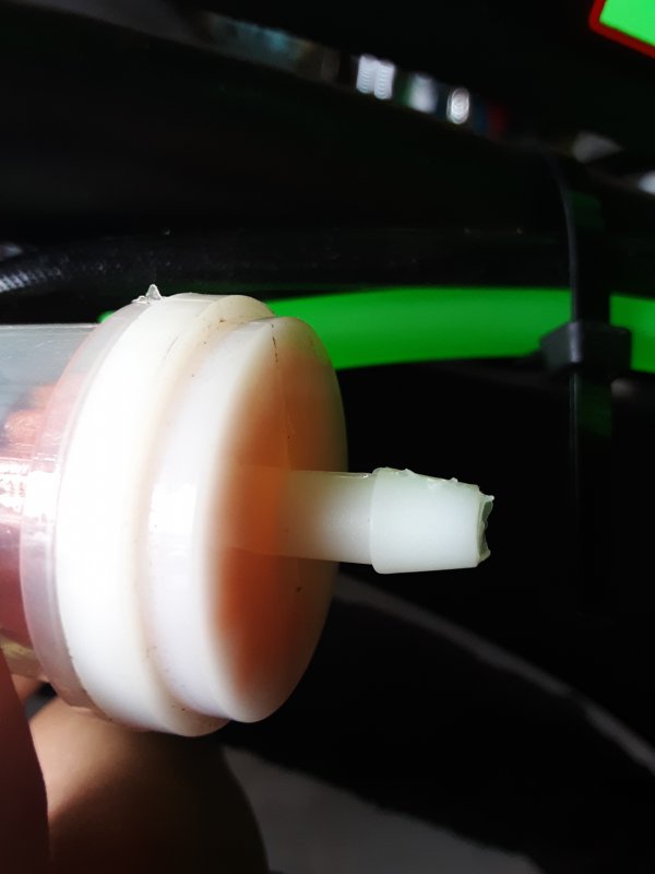

Update: I figured out what the issue is. Here are a couple of close-ups of the filter inlet
And here is one of the line: 20200724_173925.jpg
The problem was trusting the factory that pumps these out or their QC. Lesson learned, will try not to let it happen again.
Was that the filter shipped with the kit which I am assuming it was? I threw away the one shipped with my kit and got a bigger
clear plastic one.
