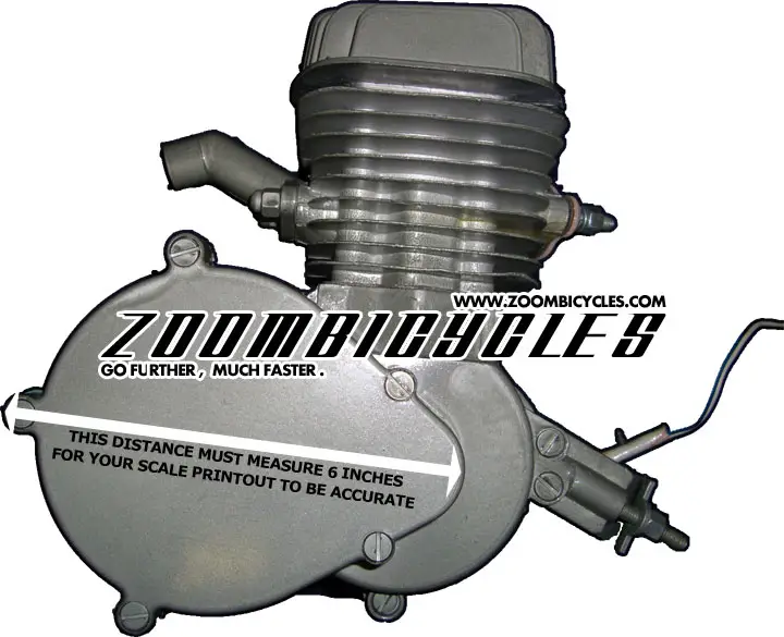

Hea thanks for your help on the 66cc/80cc confusion BigBlue. And yes I’m somewhat mechanically inclined as long as I have instructions. And I have a shop to work in. And plenty of time to tinker around. At the moment I’m trying to figure out what kind, and size of bike I need. I read somewhere where this guy used a piece of cardboard sized to a motors footprint and used that when shopping. Unfortunately I lost the link. Being height challenged (5’6”) I need a short standover height. Was thinking of getting a larger frame and using 24 inch wheels. Maybe that will work. Getting the right bike is pretty critical as I already have a garage full of bikes I’m not using now. lol
