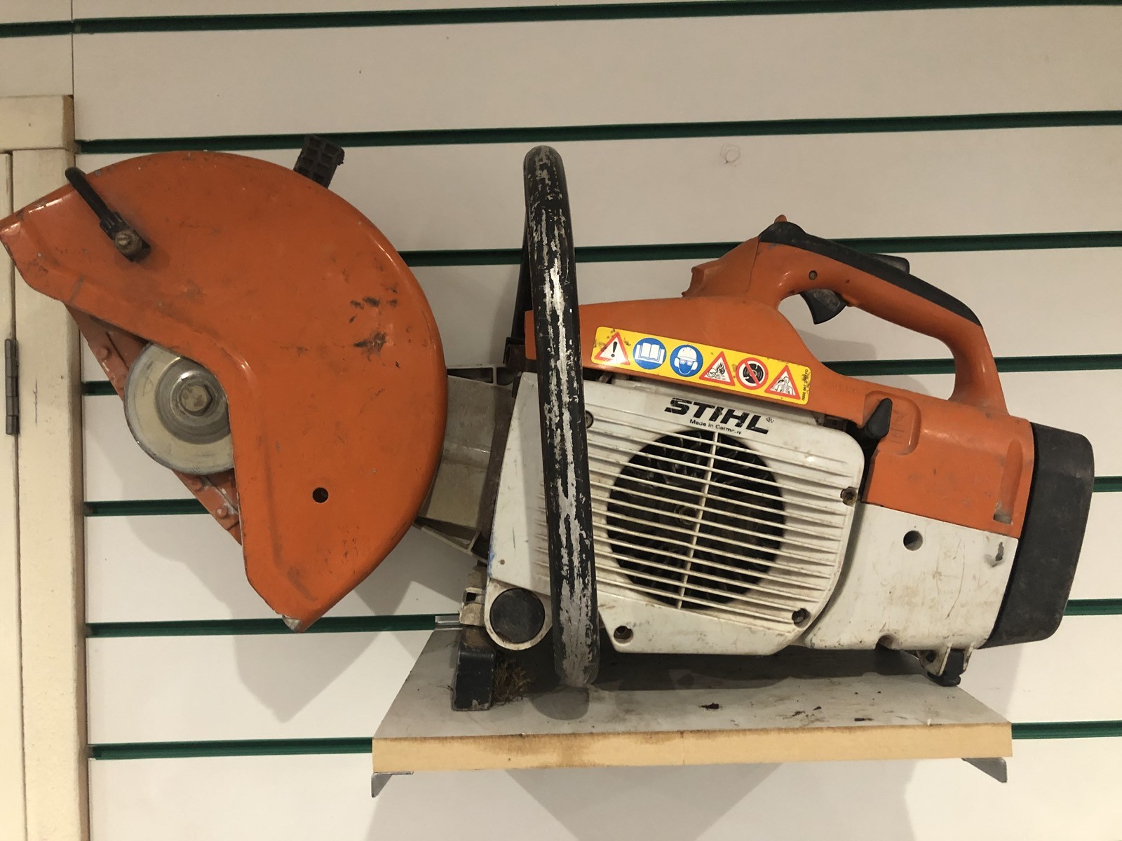

    Although they're expensive, cut off saws offer the option of roller drive against the back tyre.
