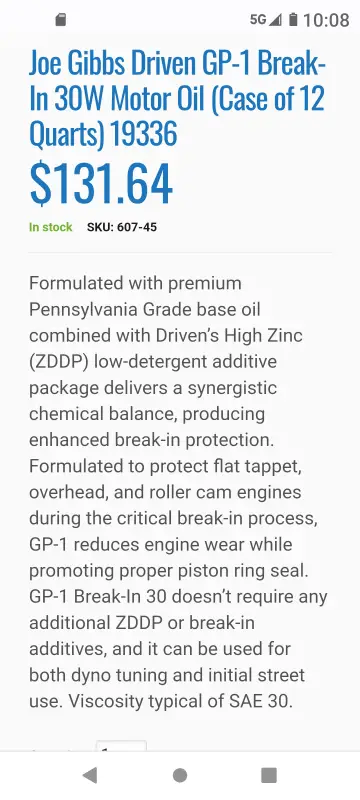

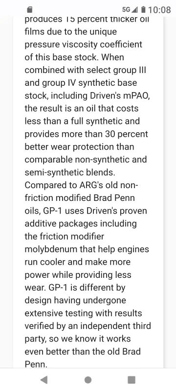

Joe Gibbs comes in 30w non detergent which the diesel rotella has and you don't want...

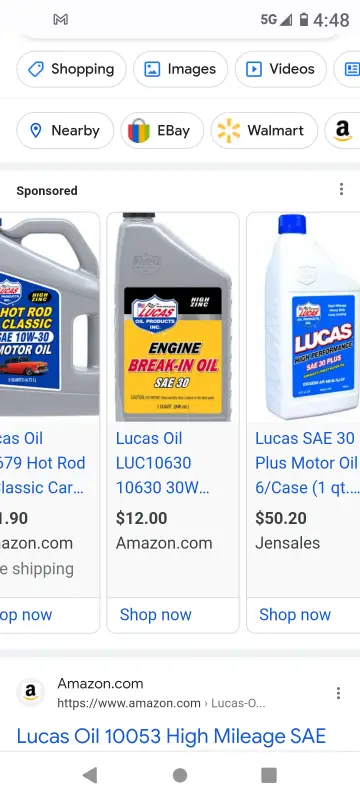

Vintage car oil should be available in 30w there's 30w break in oil mixed 1 to 4 of the same conventional like Lucas after break in... Off road use only because of catalytic converters so it's pricey and probably online
