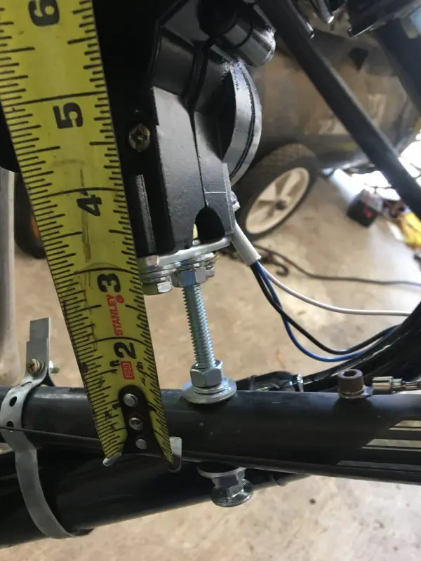

What is the best way to mount the front motor mount when it is about 3 1/2 inches away from the bike the instructions say to drill a hole through the bike and use a long bolt with the special adapter plate I did this and my bolt may have been cheap but it broke within the first 2 miles, it was Very secure with back up nuts on all sides to lock it down and my two-stroke seems to vibrate a lot more than I thought it would any ideas on cutting down the vibration and securing The front motor mount

Sorry to here that, should study the forum before doing. Never drill a frame without first welding in a sleeve to keep the frame from crashing.
Next never use rubber inbetween the mounts, mount them solid , you are going to have to find a a exstension from one of the sponsors on side bar. Welcome aboard.......Curt

I would add, that thin sheet metal shims should be used for mounts that have a very small area of contact on the frame, such as muffler clamps, and u bolts themselves. I do this to try spread out the area of pressure on the frame, and avoid fatigue cracks.
I personally cringe at the idea of drilling into a frame, but Curts recommendation would make it alot better.
good luck and enjoy. it will be frustrating, but ultimately rewarding if you can work it out.
