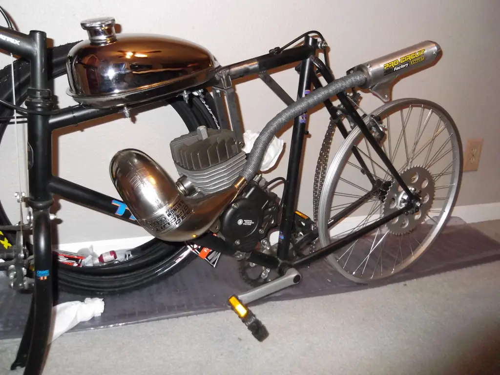

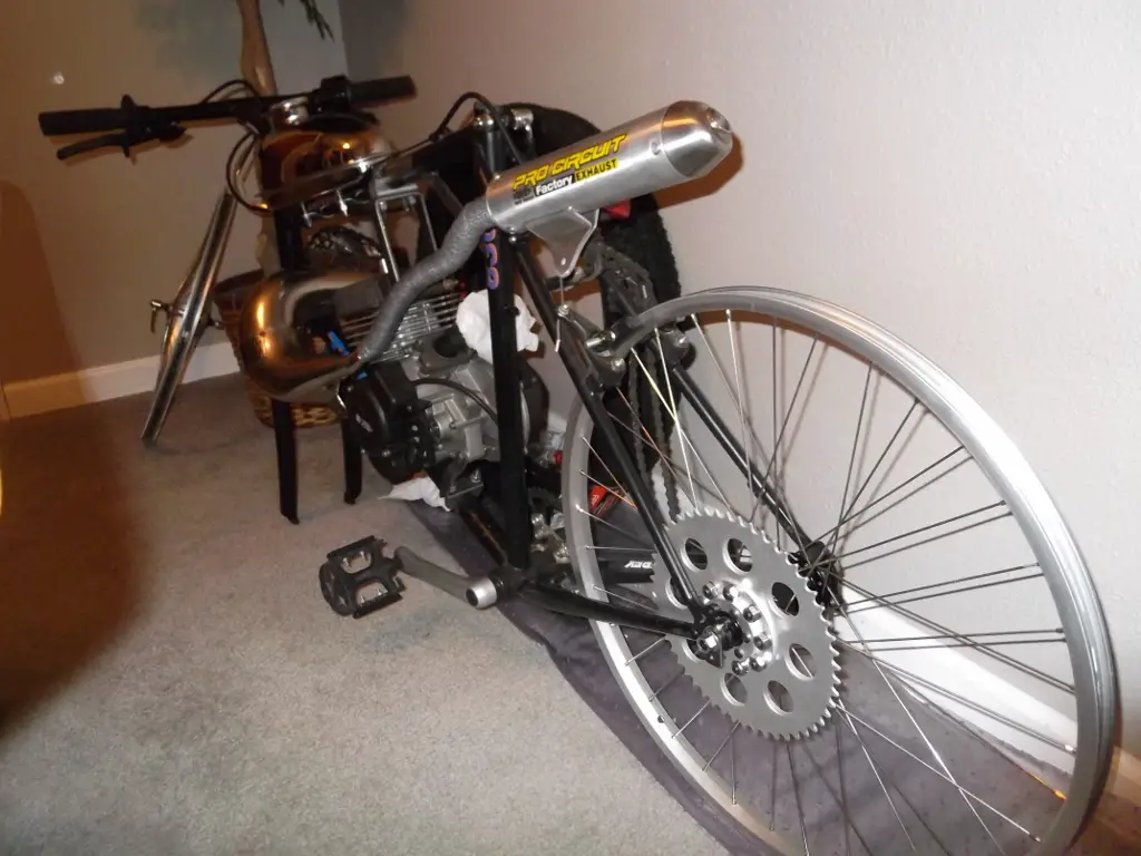

I went ahead and bought some header wrap for my exhaust. I also purchased a chrome gas tank from JNMotors (last resort). I am waiting for my .625" sealed flanged bearings to come in so I can finish my chain tensioner. Hopefully I can have this bike on the road by this weekend! Here's a couple pics.

Thats a sick pipe I love it. I can TIG you up a behind the seat jug style tank if you really need one (based on a vintage motorcycle oil reservoir ). Just out of curiosity how much was your S6s with all the machine work?

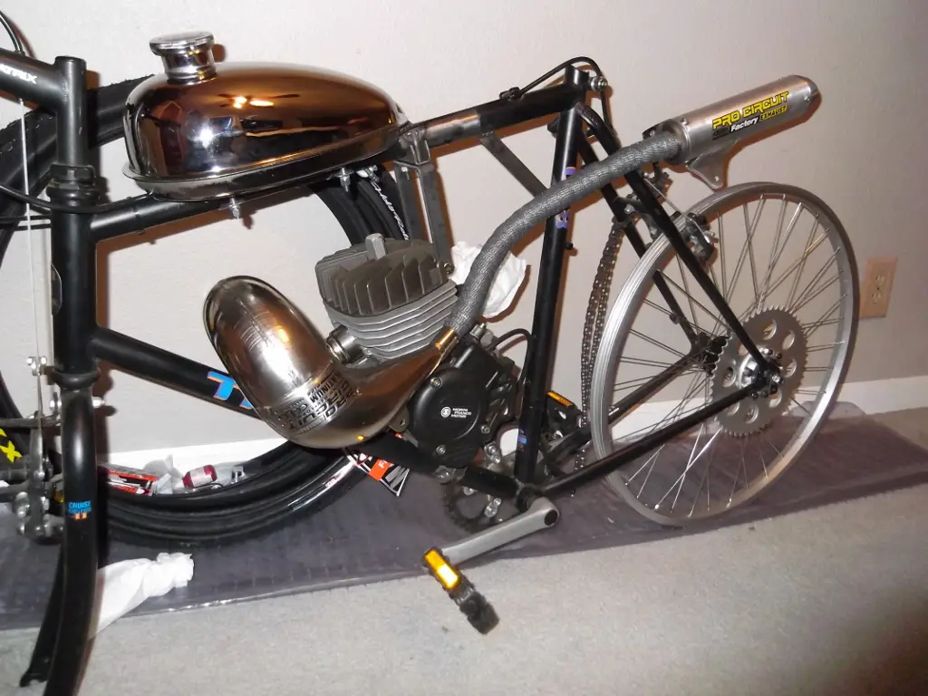

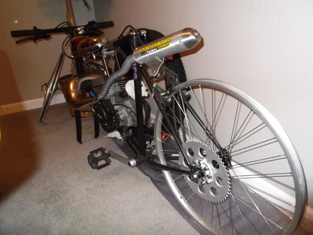

Well, after re-mounting the motor not once, not twice, but three times (thanks to Dave for bringing the motor position issue to my attention). I finally got my bike together. I tell you what you DO NOT want a 16 yrs. old kid on this. Great acceleration , great top end, and still breaking it in. It's almost to the point of "too much power for a mountain bike". Love it! I will post some videos on youtube. I'm thinking of having my exhaust pipe bent a little more to level out the silencer. Here's some pics.

Cool! This ended up being a real nice build. I have an ItaliJet pipe that looks like its been pounded with a pipe but it was done at the factory to clear the motor and frame it came from.
And, yeah, that's not a bike for a kid. Seems like none of them have any idea of how to own a bike like this. When they break things mama is supposed to get a new, better one that won't break. I wouldn't let my now 20 year old ride my bike, I know how he is...
Good job on the finished product, I wasn't ready for how violent these motors are when they are wound up either. What is your rear sprocket tooth count? Did you get your clutch dialed in?
