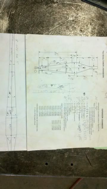

Re: modified 66cc Ht in bmx
Decipher this mess and build a pipe. Its a nice low rpm pipe that makes peak hp around 8k and limits at 10-10500. Shorten the parallel wall section to three inches long though, I never made that correction on the paper.

thanks for the pipe info, i have some tricks up my sleeve for the future. sticking with our original project outline the next pipe will probably be made when we convert the motor to run on Methanol, so all the numbers go out the window due the the reduced EGT's

Ethanol didnt change the hit of the pipe that much. My first pipe didn't really care which fuel it had.
