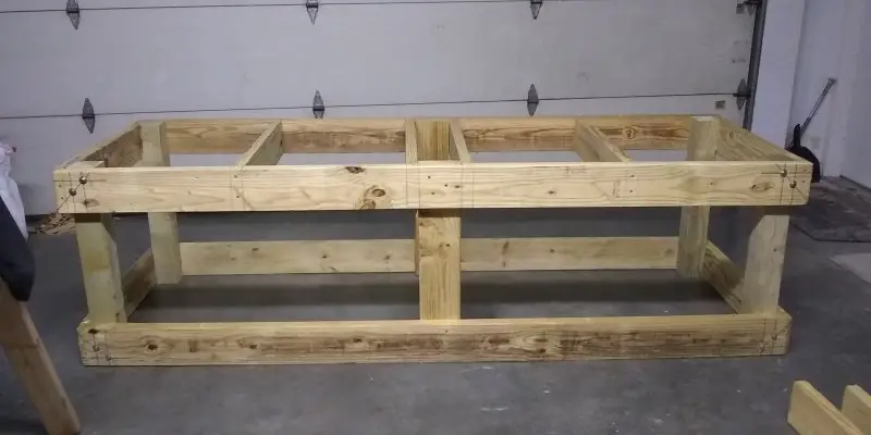

Thanks Tom, the bench was built this summer with 2x6 and 4x4, lag bolts and deck screws. So far have an swg-25 tube bender, hf tube roller, compact bender, vice and tube notcher bolted on it. The tube roller required some re-engineering along with the other tools. Swag off-road company sells every die possible and makes keyed shafts for them to work nicely. Really like those servi cycles and don't mind the sharing at all. Actually encourage it.

Lol Tom, my table is quite simple and crude but purpose built for bike building. Will be building a frame fixture some time soon and hopefully start designing some frames and forks. Here is a picture of the table design, cost 200 USD with a ten percent off coupon. Wanted it to be heavy so it didn't move. 8' long x 33" wide x 29" tall

Once again had to look up anvil height and sure enough the table comes to knuckle height, myself coming in at 5'6 on the drivers license but more close to 5'5 to be fair. My last girlfriend swore she was 5'5 and I was 5'6 but always said I had "bad posture". What can I say I like to relax haha.

I agree with Tom that you've constructed a fine bench and to your personal specs which I find to be essential for all manner of projects not intended for sale to or regular use by others. I build to suit my needs rather than those of others & encourage others to do likewise and as they determine to be proper for their requirements.
