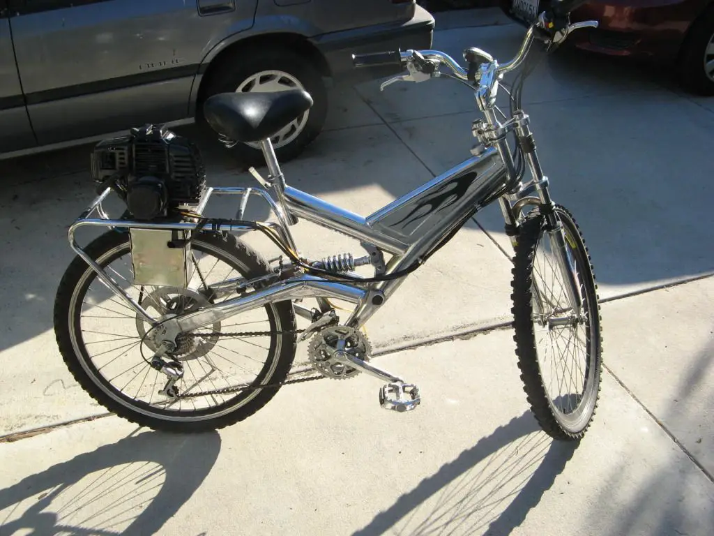

MBA Motors Mortorized Mountain Bike Anyone?? HELP??? HELP.....
CLICK PICTURES TO MAKE THEM BIGGER IF YOU WISH
sorry i havent really had time to clean it. And the last time I did it rained out here for the
first time in LA and it got messed up afterwards.
when fully clean, its such a good looking bike.
i have to fix the battery door with a lock. (i lost the key) and clean the rust spots.
other then that, she runs like a champ, just not up steep grades. Even with pedal assist. :(

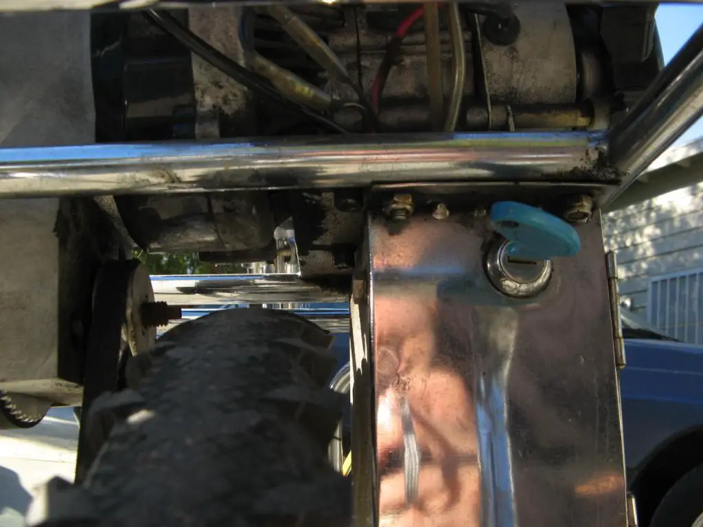

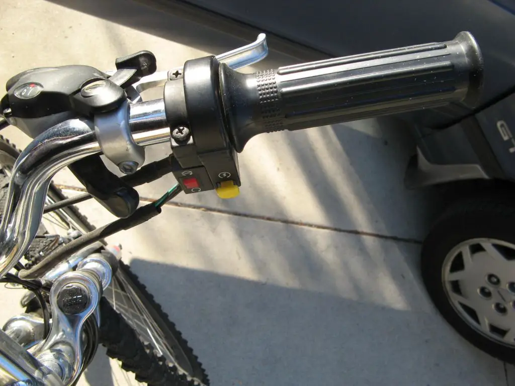

you guys see that it has a turn key ignition. to turn on and off the ignition, and the grip is the
gas, such like a motorcycle.
the batter just ran me 65 bucks 2 months ago....then, low and behold, it doesnt have an alternator.
so i had to buy a trickle charger...another 23 bucks at wally world.
That's a nice looking bike!
Yep, it looks like a Mits clone w/electric start.

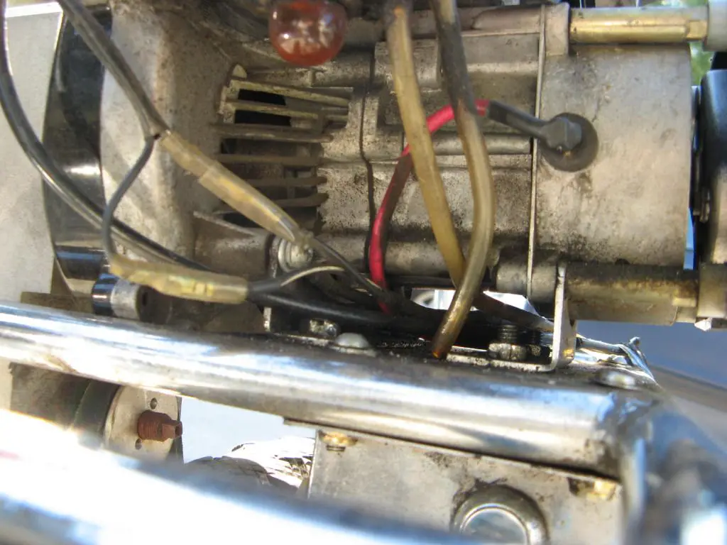

You can pull start too, correct? If so, you only need battery for lights.
i can, but its a pain to pull start it....it really is. its well worth getting a new battery
and trickle charger.

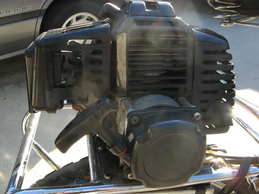

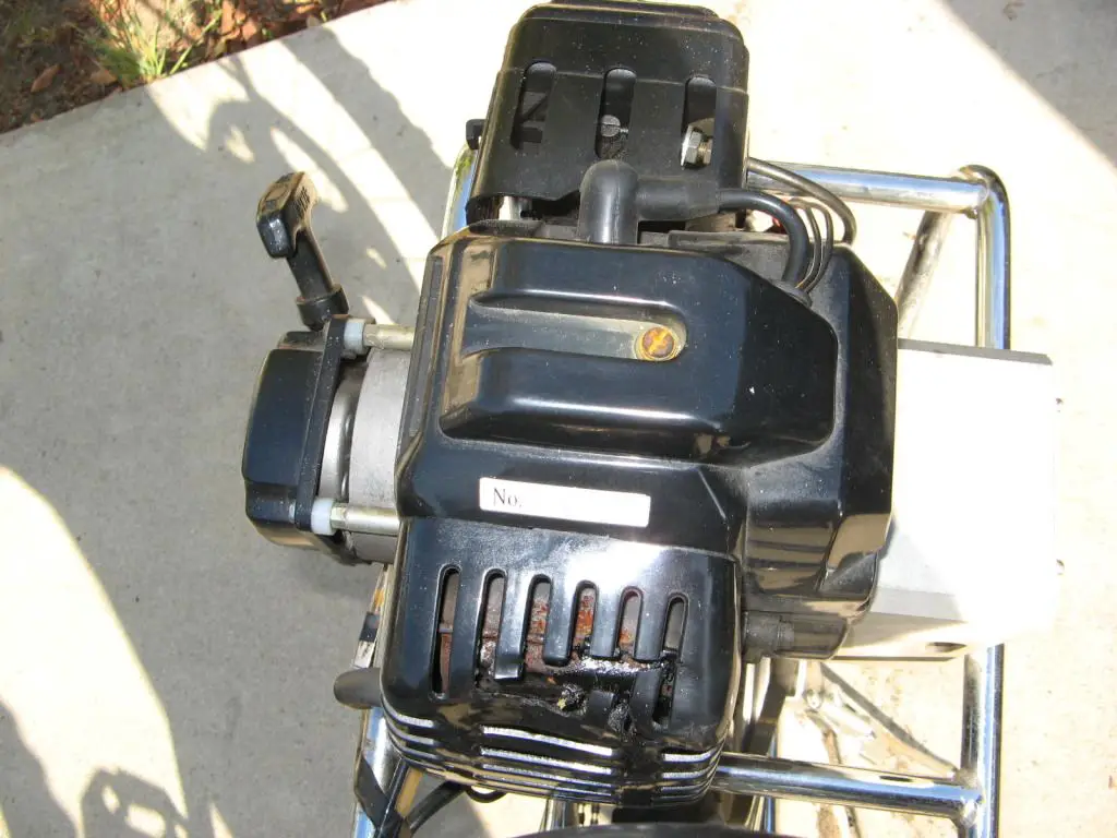

Can you take the black cover off the engine? I see a screw on top there.
Digital Cameras and camera phones are great for learning as you go. Take a pic, take something off (even just for a single screw at a time if you want, whatever makes you comfortable), take a pic, and keep repeating. Run the pics backwards to reassemble. Lay the parts and hardware out in a clear area as you go, fasteners with parts.
Some parts of the learning curve are steeper than others, but everyone here can give you a hand up when you need it.
ill take a picture and post it by the weekend.

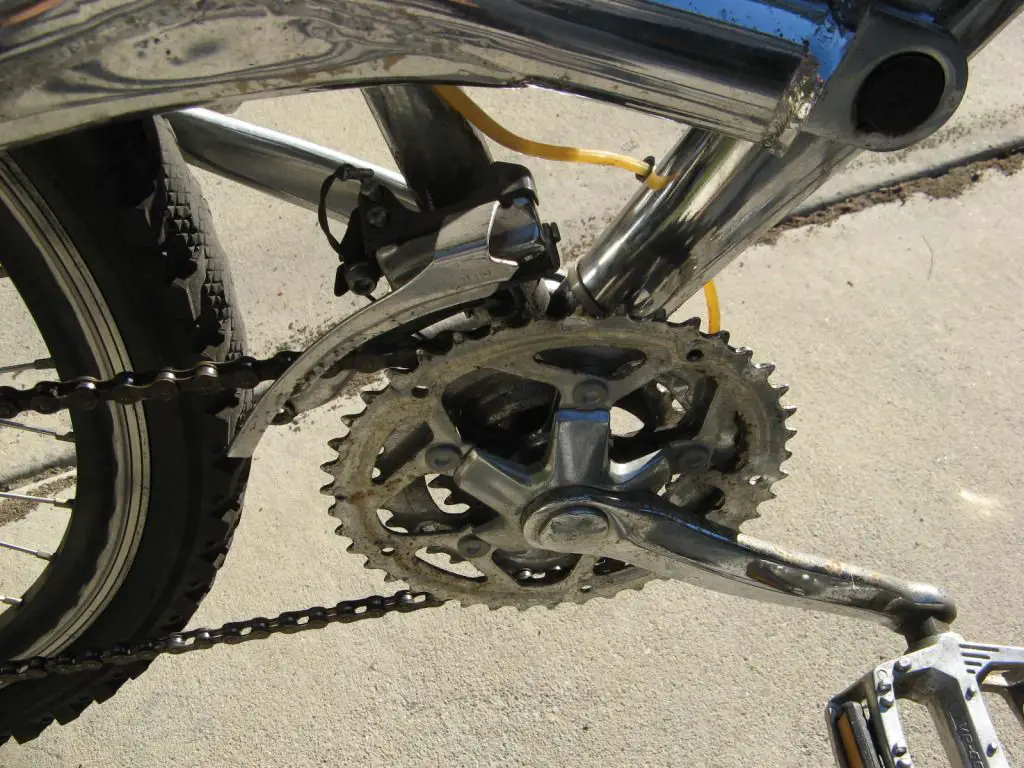

so my question is. What can i do to get more power? Just another wheel cog??

I have at least 6 of then! lol When putting my first friction drive bike together in 2008, was adjusting the carb and idle speed. The heavy starter wire hit the frame, thought someone was welding in my face. No battery in the bike or anywhere near. They charge big time. You may need a rectifier or some such thing.

It looks like a belt drive reduction box under the metal cover in the pics, will look again.
The Titan 50cc 4 stroke should bolt up to the box and many other engines with the 76/78mm centrifical clutch. Mite need a longer belt to the rear axle if the motor sits higher.
Try a new plug? That same physical size motor comes in 49cc around $100. The Harbor Freight 52cc water pump and auger motor is the same size will bolt up nicely.
If there is room to put a larger pulley in the bottom of the tranny or bigger on the rear wheel axle that will help. That must have been a very costly machine when new.
The Hf 52cc would be a big improvement and would be a simple switch.
Not sure about the starter, and they can be a bear to remove. A friend has a HF 52cc on a cvt and now a friction drive, near 2 yrs now and loves it. Pd around $100 on sale with a extra coupon.
