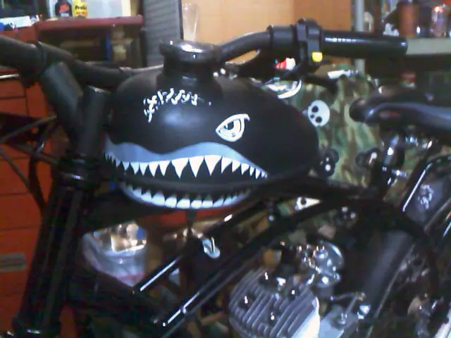

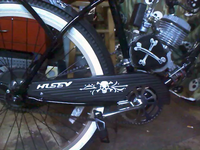

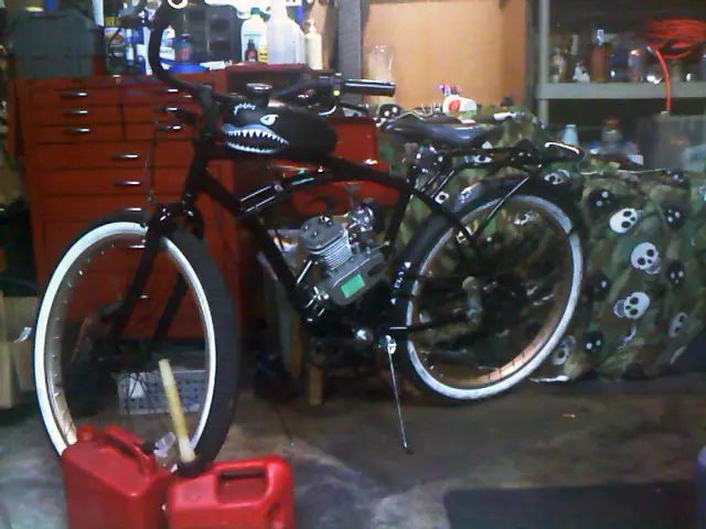

Here are some pics so you all can see the paint and assembly thus far... I named her "Franken Hussy" because of the adjusting I did to the huffy emblem I had left on the peddle side chain guard....
