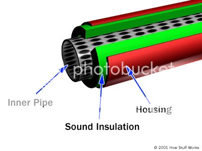

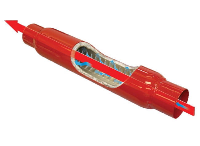

How wouldn't that be an exhaust?!
It's NOT an expansion chamber...
It's NOT a typical baffled muffler...
and I have noticed that much of the
exhaust and muffler talk around here does
seem to center around baffles and chambers
and stingers... but that's not what this is.
Here are a couple different pics I found online
to show exactly what we're talkin' about here.
and I'm not claiming to have made a "performance
exhaust"... I just bent some pipe and tried to make
it look cool. Thats all.
