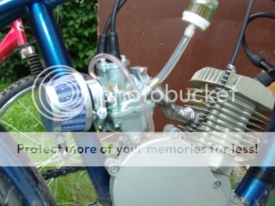

This is'nt as nice as your billet intake but might solve your problem.One came with my CNS carb.
http://www.gasbike.net/bike-motor-engine-off-set-air-intake-pipe.html

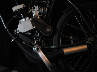

brnot
(photo is angled a bit, the carb isn't angled down that bad, but it is a little)

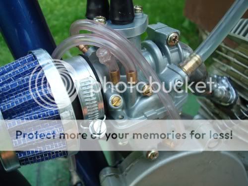

I tried my carb setup like the original post pictures and it won't work. After 2 days of not being able to ride, I also discovered that my mixture adjust had gotten turned out to the point that it wouldn't idle or run right.
If you connect vacuum from the top barb beside the air filter, you'll cause your float bowl to always have negative pressure, which keeps fuel from going up the needle and into the intake. Don't connect any thing to that barb except to plug it. The only thing I know for sure works on the bottom float bowl tube is a drain hose to direct fuel/oil away from your bike ~ mine has been collecting fluids for a couple months and it looks nasty!
My c-clip is at the top of the original carb needle and the mixture screw is actually only one to 1.5 turns out, for best running/speed conditions.

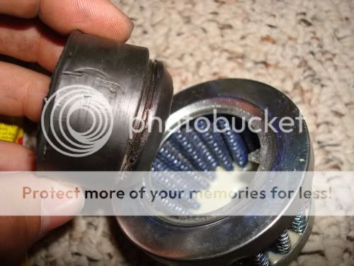

The O-rings that are supplied with the intake are fuel proof neoprene...if you use a natural rubber O-ring the fuel will eventually dissolve it.
A loose carb would also cause the O-ring to errode from the constant vibration.
