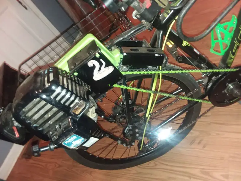

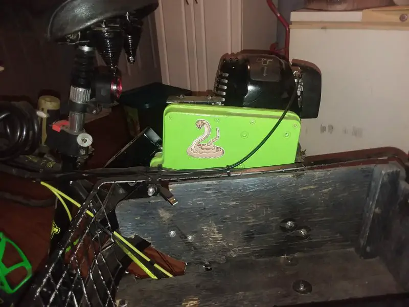

Just want to post my Staton Inc 18.75:1 actual gearbox (not a chain/belt drive reduction box) has been going stong for 12 years without a single problem.
