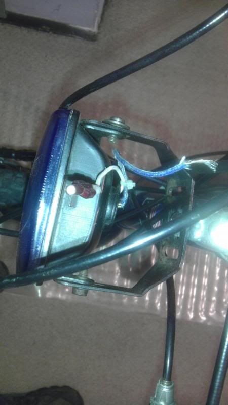

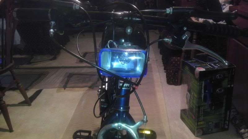

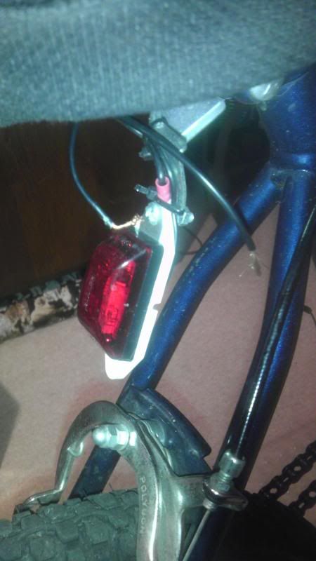

The headlight is actually a halogen fog light from a car and the taillight is an LED light from a motorcycle.

That halogen light is going to be very high wattage, and its not really practical to run it on batteries without a built-in charging circuit. Assuming that the high wattage doesn't cause the battery to overheat (which most likely it will, and overheating batteries is EXTREMELY dangerous), it won't run for very long on a single charge. Most likely no more than 5 or 10 minutes if you're lucky. And if you connected it to your magneto, it wouldn't work at all because the engine would never start. You'll need an led with fairly low wattage to make a decent battery-operated lighting system.
