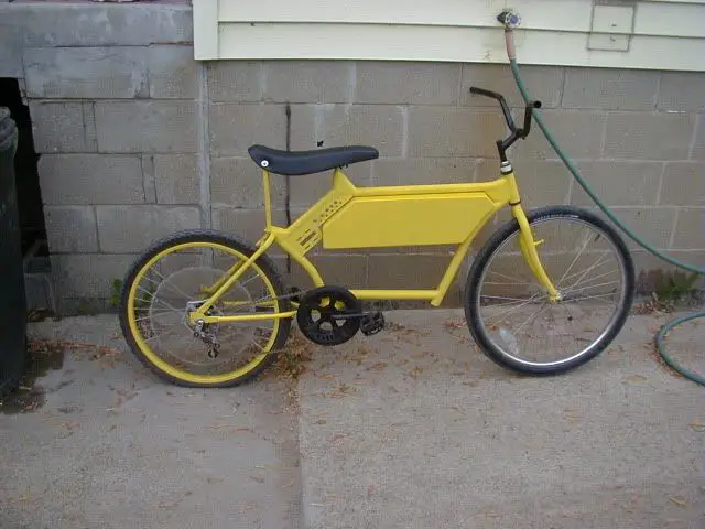

This is a post of a very quick & dirty throw together bike for the june 5th race in Ohio. I started the chopping of old Huffy 24" girls mountain bikes (all curb side pickups) on May 5th. Lets see if the photo works or I am still too new here:

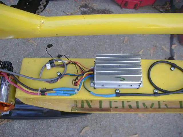

after adding some electrics & a battery box I am here:
a better view of the the thing....no beauty contest winner.

That front wheel should really dig in...but I am not sure how you are going to turn with no handlebars, and I don't even want to guess about the seat post.
What kind of electric power are you gonna use?
Cool stuff! I'm not sure about seat tough (subjective opinion , regarding my ...). Very clean looking (maybe a few stickers on the flat surfaces would be interesting...).
BTW , rear wheel sprocket (huge transparent thing) is made of ...? Maybe polycarbonate?

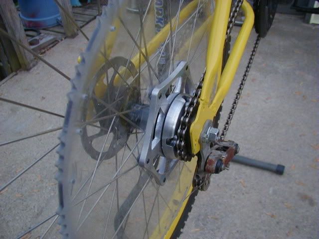

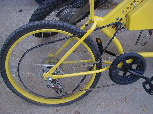

Polycarbonate 121 tooth (about to be 131tooth) Definatly need some decals on it to "race" it up some. I am working on that.... I hope my race tires show up friday morning......I am working on a 2nd bike for the event right now (playing hooky from work shhhhhh.)
The seat?.....Im not crazy about the look either, but it is functional & allows mw some mobility on the bike. I will be getting sideways on this one in Carrothers.:)
a better look at my "ghost" sprocket:

man that is to rad! does that big gear freewheel? how do you go about fitting 2 freewheels on one hub?

I have had a little luck with the bike. Been clocked at 44mph so far. But I am still blowing electronicts pushing the envelop. I was out to shoot video when I cooked the lastest speed controller.(its out to be repaired by the maker) but overall I am a bit tired of trying to get the performance I am searching for. I have designed another gearbox set up that should take quite a bit of strain off the electronics. I will start that soon & start a build thread for that here.

Dash, yes the big sprocket freewheels. It is a custom adapter (home made) that bolts onto a standard bmx freewheel with another threaded section to add a second freewheel to the pedals. (not a fan of freewheel cranks) The whole project is home made come to think of it LOL. I have access to large cnc equipmet so I am quite spoiled when it comes to prototyping parts.
Here is a great tutorial for getting twin freewheels:
Endless-sphere.com • View topic - Mounting TWO freewheels on one rear wheel hub
