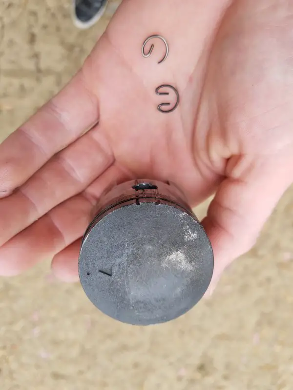

From the looks of the piston the clip came out and started the damage, be sure to clean all the pieces out of the crankcase or you'll damage more parts.
Where the gouging began isn't where the 2 ends of the seal meet, so I don't think it was the seal that initiated the damage. Not that it matters too much, but I think the 3 prong plug heated the jug up to the point that it made the aluminum brittle and caused a blowout in that area that has minimal material due to the amount of pressure applied from compression and combustion. I'm just thinking out loud though, I'm no expert.

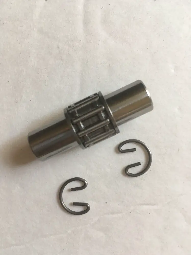

that gouge looks like a wrist pin clip with two grab bars came out
this kind
rather than this kind

I doubt the plug had anything to do with it, if so the top of the piston would be scorched. What does the top of the piston look like?
Scorched. I'll send a pic in* a few when I get home. But it's scorched with plenty of black residue
