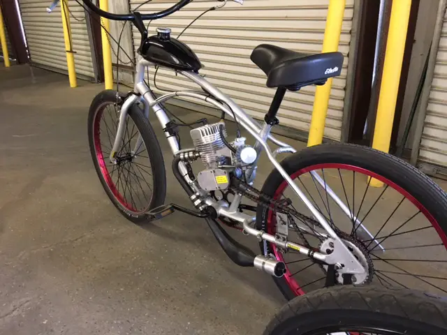

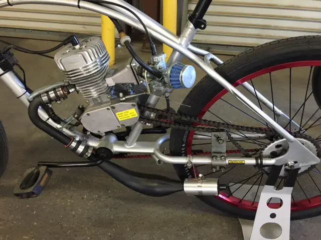

Mine is up and running, so far so good. Ports looked good and overall was pretty clean for a China motor. Still want to get 2 tanks through it before I put the coals to it.
No, only thing is it takes some time to warm up....have to leave the choke on longer than the other motors I have.

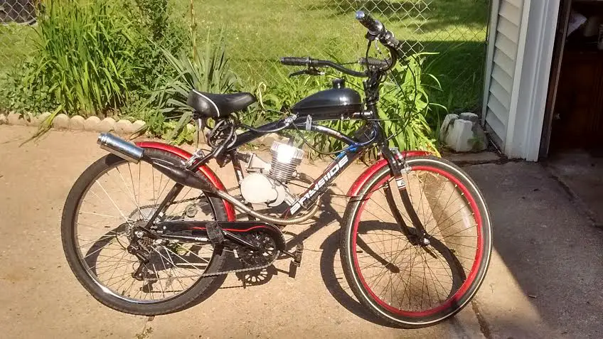

I have a gt80 on my bike. It runs fairly well. Not like I was hoping but it'll do 30 with a 240lb rider 44t sprocket. My motor diesels at wot as well. Does anyone who has torn apart one of these know which internals are being used? I have yet to tear mine down to see. Going to be doing some mods soon due to what I have just read on this thread. Thanks for all the info everyone.
http://motorbicycling.com/attachment.php?attachmentid=82814&d=1466133986
Hard to say what the end power and speed with this GT80 will be.
I do know I am throwing a KTM 50 together next though.
