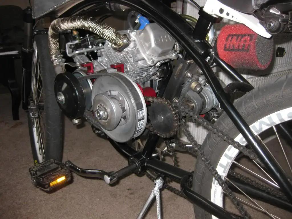

The jackshaft in that first picture is mounted on the crankset - here is another view of that:
Some of those Harley bikes had 3 chains, others had only two & a one way clutch in the crank hub.
Here is the equivalent on my belt primary bike:
The cranks mount on a 25mm shaft that runs in a pair of sealed ball bearings that are pressed in to the hanger bracket.
The reduction assembly has both driver & driven mounted to one sleeve, with a pair of sealed ball bearings pressed in to it. It is held on when the crank arm is mounted.
With it all together is looks much like an original machine:
