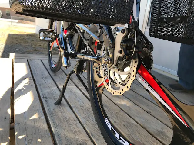

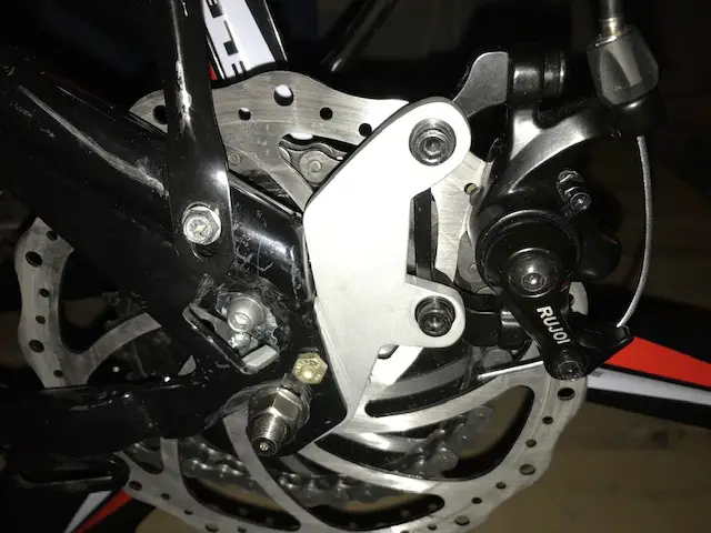

With this configuration, you could even enhance your bike by adding mag wheels, enabling a disc brake setup similar to the one on this bike. It's a solid approach for anyone looking to optimize their ride.

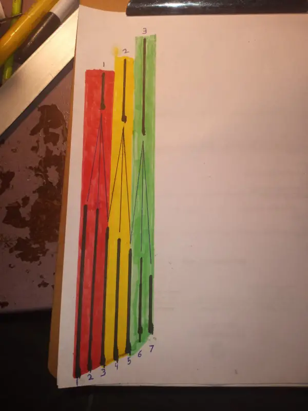

With my bike, the Sidewinder, I have a 1.6 hp engine, I'm a large person, and I live in the mountains. I use a triple chainring shift kit with a 7-speed 34-13 freewheel. Immediately, one will think of 21 gears. That's way too many. With a 3x7 drive system, you don't have 21 different ratios you have 21 different shifting combinations. Many of the ratios are redundant.
The Sidewinder has the widest reduction range in forum history 66.79\1~16.25\1. I also invited a color-coded one-hand shifting system. Here's how my system works:
Red Gears
Steep hill climbing
1(1-3)
Yellow Gears
Around town general use
2(3-5)
Green Gears
Open road use
3(5-7)
Notice a chainring is only shifted when in either sprocket (3) or (5). This keeps the bicycle chain in a fairly straight line. Starting Gears are 1(1) for starts going uphill, and all other starts 2(3) is used.

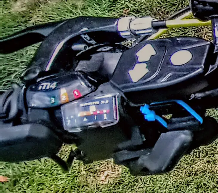

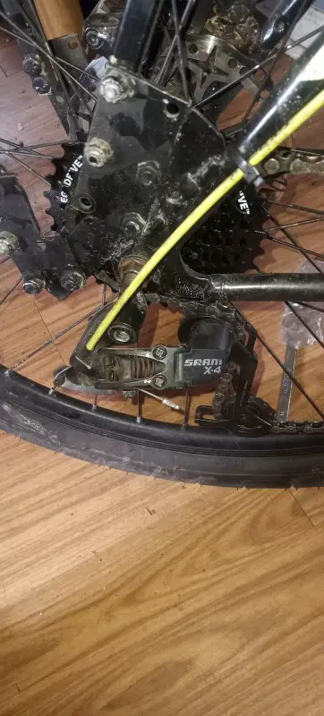

I personally use a Sram X4 rear derailleur and a Sram X3 shifter. I like it because it's all metal no plastic parts.

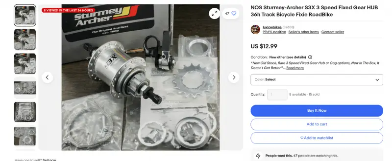

the fancy expensive s3x you said is around 300-400 dollars? Now I could be wrong but i think i found it on ebay for $13 is this the wrong one? is it lies and probably fake? im unsure with this conflicting information.
also thanks for the recomendation on the shifter and deraileur, they dont seem too expensive, i might go for them.
If it's too good to be true; then it's too good to be true. I've seen 2 stroke kits on eBay for $25. The kit never comes and you have to go through up to a 90 day process to get your money back.
