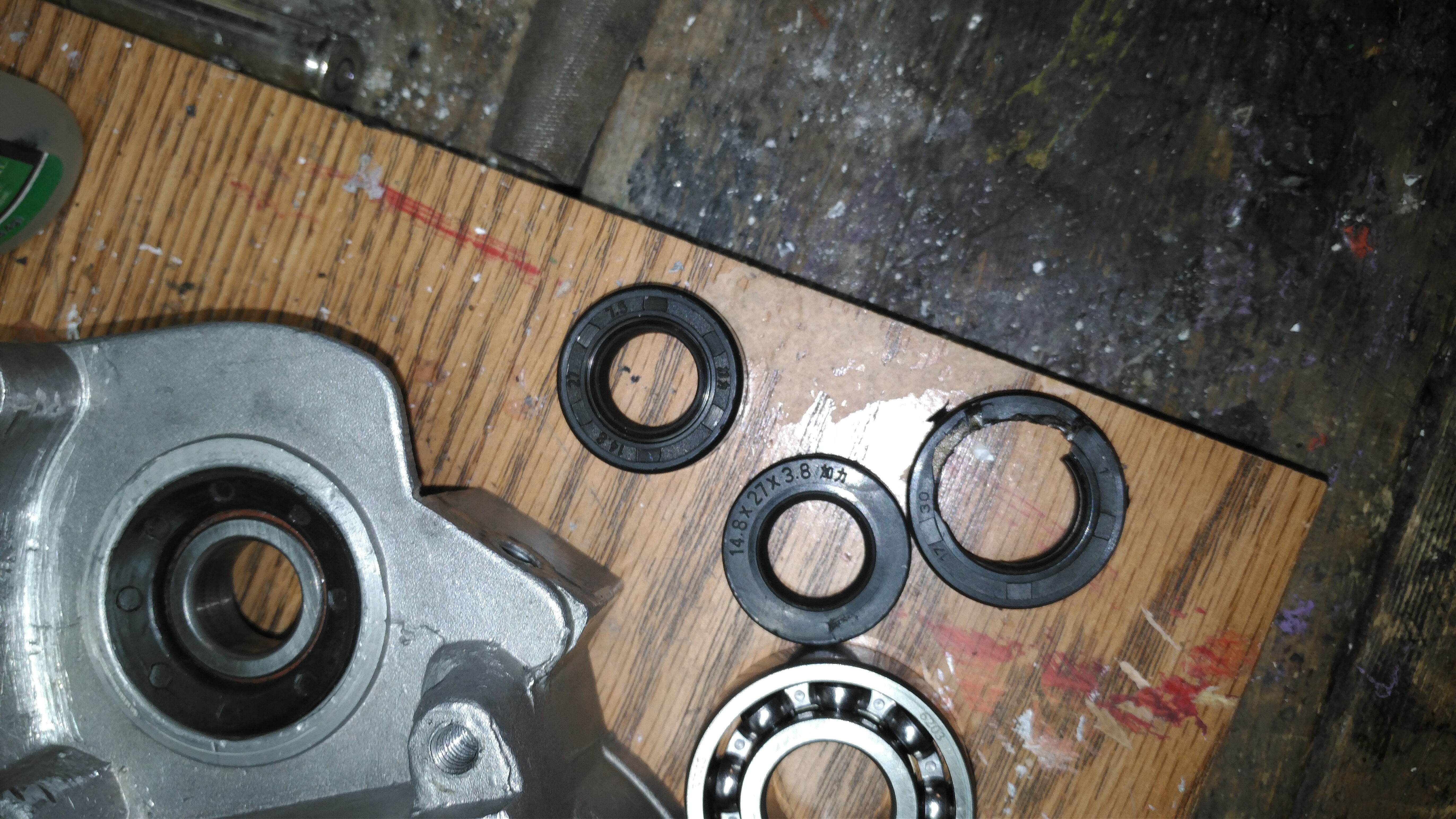

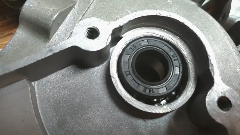

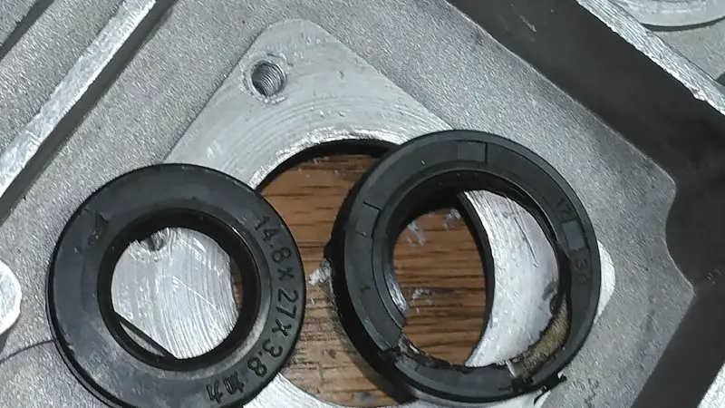

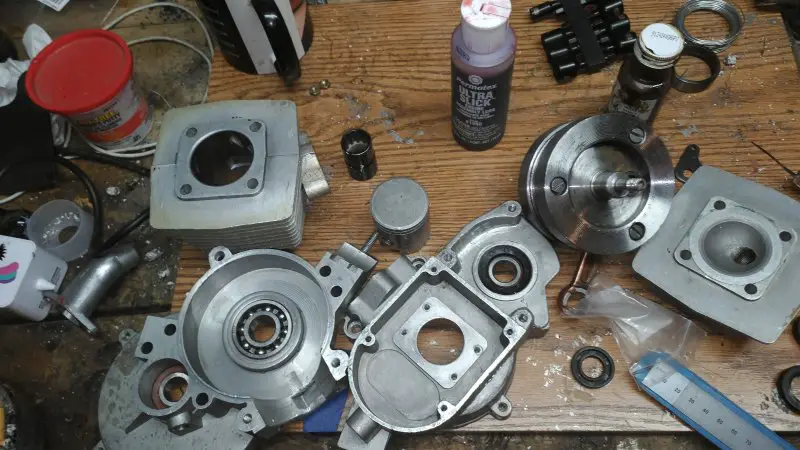

Having trouble finding the correct crankcase seals on my 48cc Chinese motor build. The seals I find and received are much too small. The one original seal is marked 17x30x7.5 but the only ones I can d find are all 14.8. It has the smaller 6'mm studs but the larger intake and exhaust ports and regular base gaskets for 48cc engines are undersized.

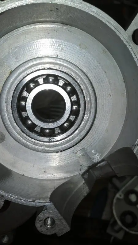

From what I can gather, correct me if I am wrong, it is unusual for the 48cc Chinese motors to have 6203 bearings and a 40mm intake. My questions us ate the larger bt80 crankcase seals what are going to work for my crankcase as I believe that variant uses 6203 instead of 6202 crank bearings. As I am finding impossible to find the correct size seals using 48,49,50 c.c. Keywords.
Anyone have links to where to find crankcase seals that fit this seemingly odd duck?

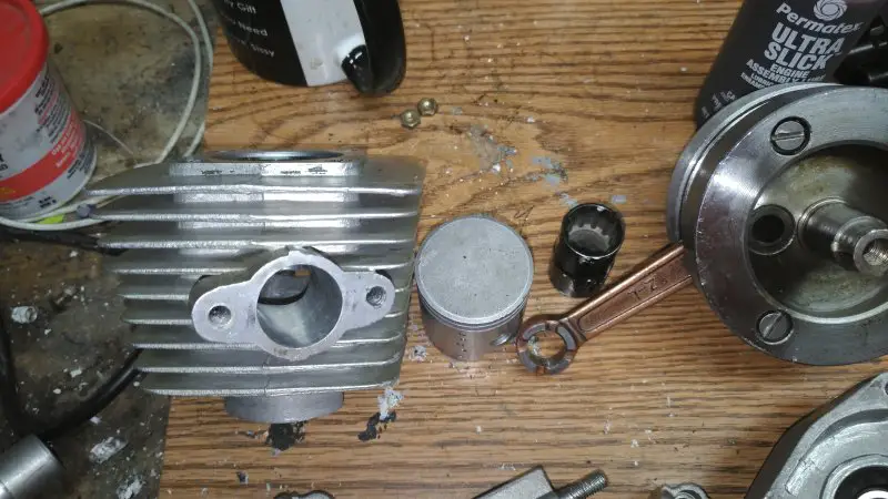

Did you mic the piston? Early 66cc engines used 6mm studs.
Yeah, it's a 49cc engine, number 3 piston 40mm.
You can see how.much bigger the one partial seal is to the standards.
