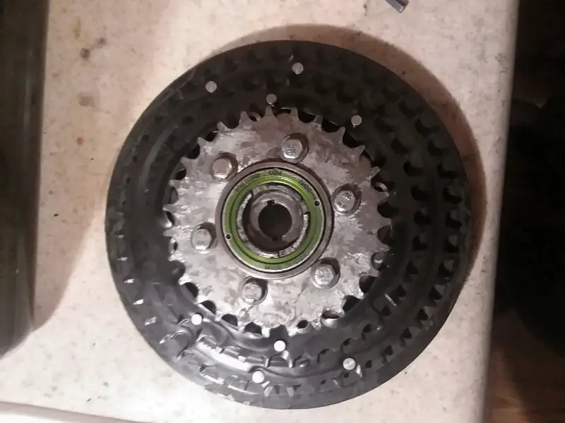

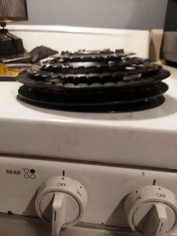

For over a decade I rode a bike that shifted 7 gears automatically. I've retired that bike and am currently building a Schwinn Sidewinder featuring a triple chainring shift kit using a custom built 7 speed 34-13 freewheel. The chainrings are 28,36,44. The 3×7 drive system will be shifted like this lowest to highest gear ratio 1(1-3), 2(3-5), 3(5-7) for 9 non redundant gear ratios. It'll also eliminate cross chaining which occurs in single chainring shift kits.
