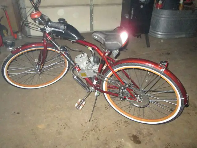

Is head on the right way?
Video running it today.

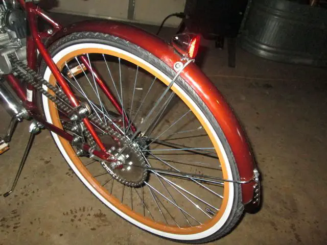

Those fenders are coming off the chain rubs on them and as stated other issues.
I kick started it but she sure has compression.

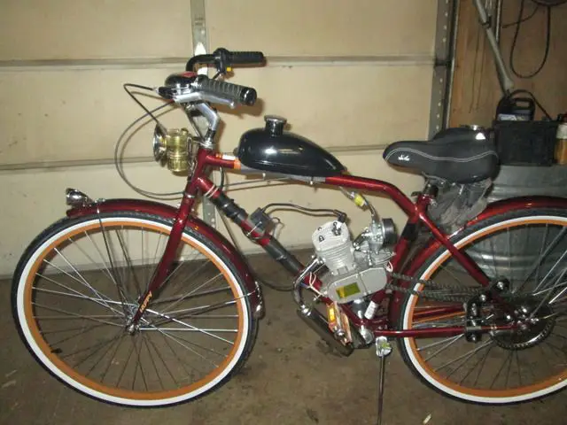

Also the manual on line calls the idle screw a air fuel screw but it would be my belief that it`s only a idle screw that lifts and lowers the slide, conformation on that ?
https://www.youtube.com/watch?v=RxJhkOJxYv8
If you have the standard NT style of carburetor you're correct. The idle speed screw is a simple mechanical stop that dictates how far the throttle slide can close.
I'll look at your vid and confirm the carb you have.
Edit: Confirmed. That is the NT carburetor. And they are great carbs for a stock or near stock engine.
You want to keep in mind that she is a little AIR COOLED engine. They have no means of cooling except from air moving over the cylinder and cylinder head cooling fins. There is no internal fan or shrouds. Don't run it long sitting still. It'll get pretty hot that way. Too much heat can damage things.

It's looking good pitchy. Another weak spot is the engine mounting bolts. Myself, and quite a few other riders have had those cheap chinese bolts snap right at the engine while riding.
Thanks, I`ll keep an eye open for that issue, the engine fit in this frame so well I may not have an issue.
Edit, removed question about muffler as I see no need to change.
Decided to keep the fenders, made another support bracket for the rear one.
Going to see if I can adapt a front brake from a ten speed on it.

Correct way to place an angle head when clearance allows is plug over the intake side. Runs a bit hotter on the exhaust side.
