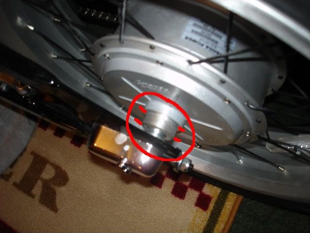

Here are some photos or my chopper, as you can see the hub is too large on the rear to install a sproket. Still trying to come up wit someway.

Are there threads that I see here?? On quads for the rear axle they have really thin axle nut's....is it possible to mount sprocket here and use some axle nut's to mount it :confused: Don't know too much about E-hub's :(

I don't know if that would work and I thought of that also. I guess that I need to see a breakdown and operation of that drive hub, will have to do some reasearch on it.
The hub is only 250 watt 24volt and runs about 14mph, would like to have a little more speed and range.

Looks like a big hub....What material is it made of?....I wonder if some "studs" for a 9 hole mount sprocket could be welded to it then simply use washers to space out a sprocket and bolt it directly to the large hub....
Just a thought,,,,Good luck!
