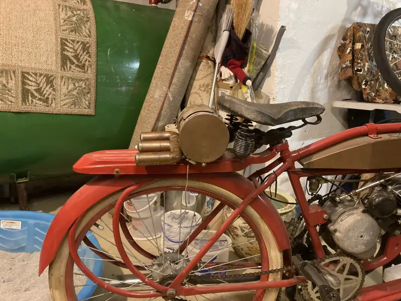

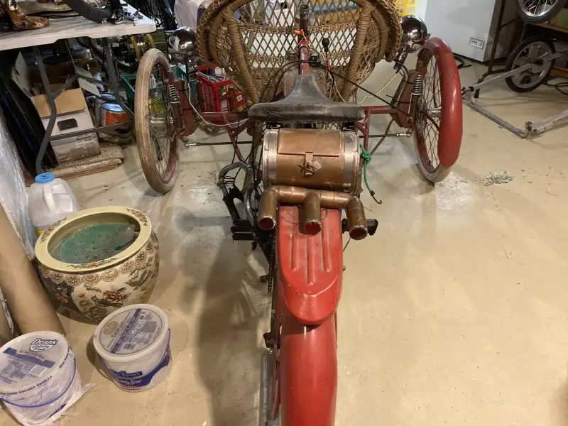

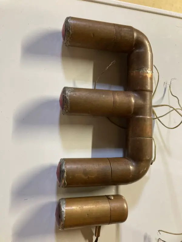

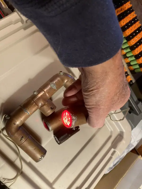

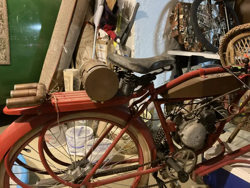

Have been contemplating the lights and am considering a copper jewel light I made some years ago for I know not what build. It was originally inspired by sitting in traffic behind a modern Harley with all the bells. whistles and saddlebags and saw this in my head and then made it using copper water pipe fittings, three led flashlight units and three stained glass jewels as used in making Tiffany style windows and lamps (I had a stained glass studio at one time in my life). Never used it and just now set it in place on the Hiawatha for a session of creative staring. The middle light could serve as a standard tail light and with some help from someone more knowledgeable than me maybe the two outboard lights could be turn signals. Voltage would be 7V @ supplied by two 3.7 v. Lithium cells in series. Even though the led units were originally powered by (3) 1.5 volts AAA batteries the 7 volts doesn’t blow the leds out and
gives nice bright light. How to make the turn signals flashers I don’t know and besides, I’m still staring…
What do you think?

The copper St. Bernard tool box can is already tying up rear rack acreage. The Hiawatha having Art Deco styling, a pair of copper plumbing tail lights bracketed to the seat and chain stays, port and starboard.
Kicker would be if you don't have more of those jeweled red lenses. Think rocket engines/

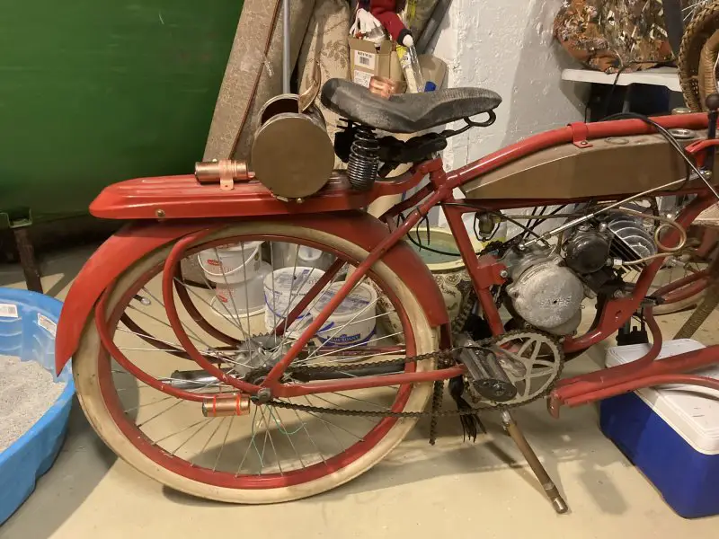

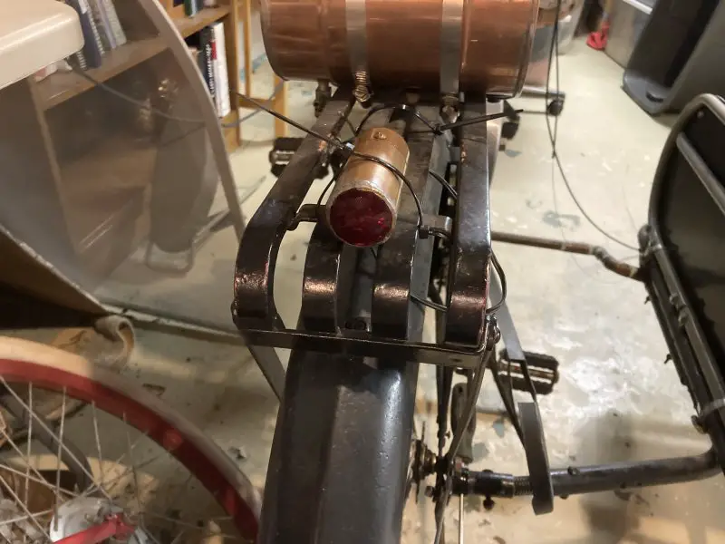

I moved the light assembly back some and did some more staring...
It's a little less crowded... but still feels too big. Don't know if I have any more ruby jewels, but I could dismantle the unit in the picture and make it in to two smaller lights to mount just forward of each side of the axle as turn signals. Maybe 3" long and have one jewel left over to make into a third shorty to mount just under the back end of the rack as a tail light. That might look good.

Curt, the problem with that idea is that the led units I use fit right inside that diameter of copper pipe. I discovered that one day while browsing the aisles at a local tractor supply and the lightbulb in me head flickered at these cheap little led flashights being both the same shape as copper pipe and looked like they might be of a close to the same diameter. I checked and the flashlights just fit inside. Woohoo! And that was the beginning of copper jewel lights…. So, I need to stay with that diameter or find other led guts. Looks like Harbor Freight is changing over to a different flashlight manufacturer as I just bought five of them at a about $1.25 each. They have 9 led bulbs inside and are quite bright for a tail light.

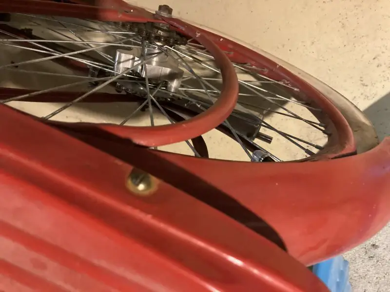

And mounted to each side of the rear rack they should work as turn signals…
…and it even has a small bolt already there holding the rack to the fender which could also hold the turn signal. I think I like the idea enough to take apart the three light unit and give it a try. And at that point it will be time to do some more creative staring to see if it looks like what I imagine it will. And if it doesn’t then it is time for plan C. At the moment I don’t have a plan C, but there is always a plan C waiting in the wings…

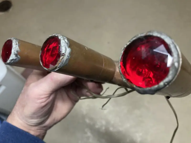

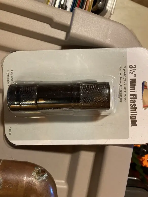

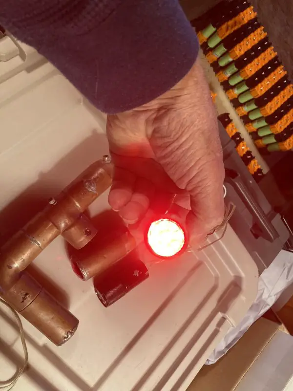

This is the little flashlightI have used in my tail lights. It takes three 1.5v batteries normally, but works well with just one lithium cell at 3.7 volts or two in series at @7volts.

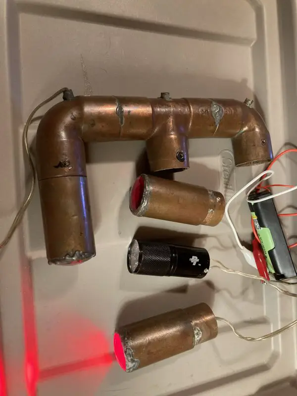

Cut off to make it shorter, it fits nicely inside the copper water pipe. I’ve seperated the units and will need to fit pipe ends for each unit..

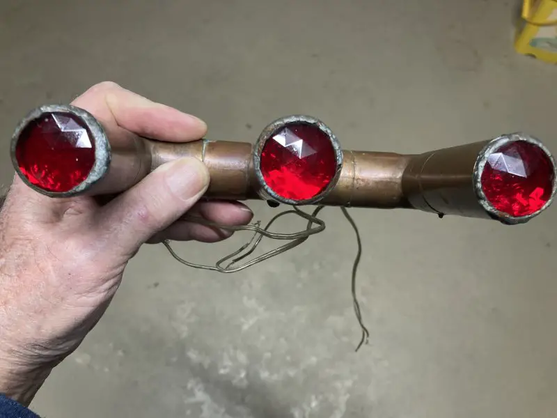

The faceted ruby lens makes it into a nice tail light. The glass disc is wrapped in copper foil, tinned and soldered to the copper pipe. And that’s how you make a copper jewel light.

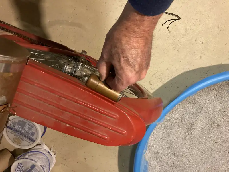

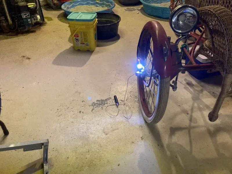

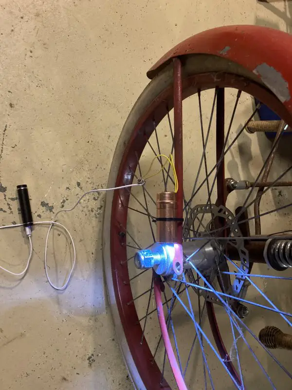

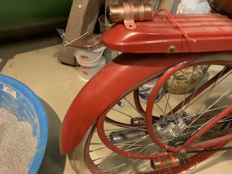

A bit of an update is in order as I wait for spring thaw and an opportunity to get to work again in the garage/shop. I’m still waiting for the clear faceted glass lenses to arrive any day now to that I can finish making the front turn signals.
Photos show lights without clear glass lenses and attached to the fender struts via red colored zip ties
The rear lights have been separated from the manifold shown earlier with the turn signals attached to the rear fender struts also with red zip ties which seemed like the simplest and least intrusive way to mount them.

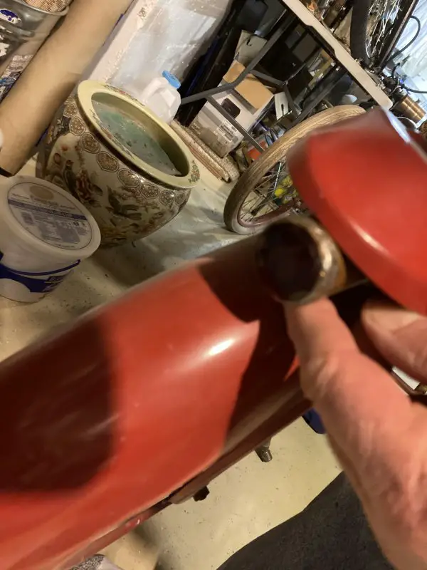

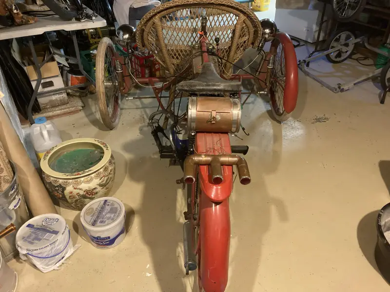

The tail light location is yet to be determined….
…whether forward just behind the driver’s seat or further back and at this point don’t know what is best… possibly to the underside of the rack…
