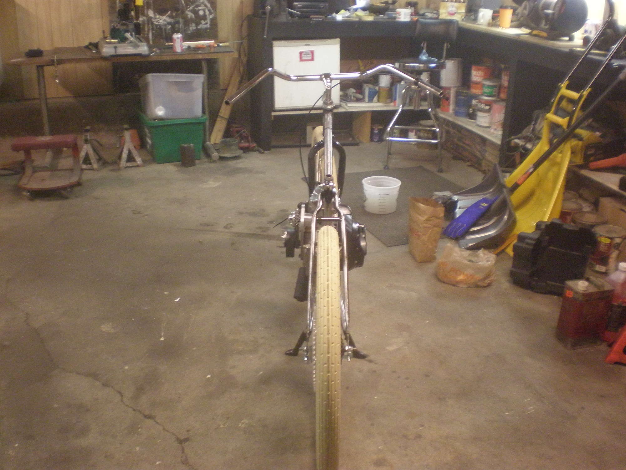

i like the aircraft remover you can get at pepboys. they make it in a spray can. but make sure you read the warning labels... :)
