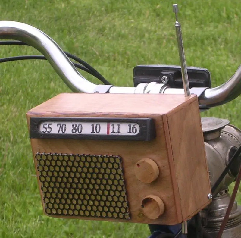

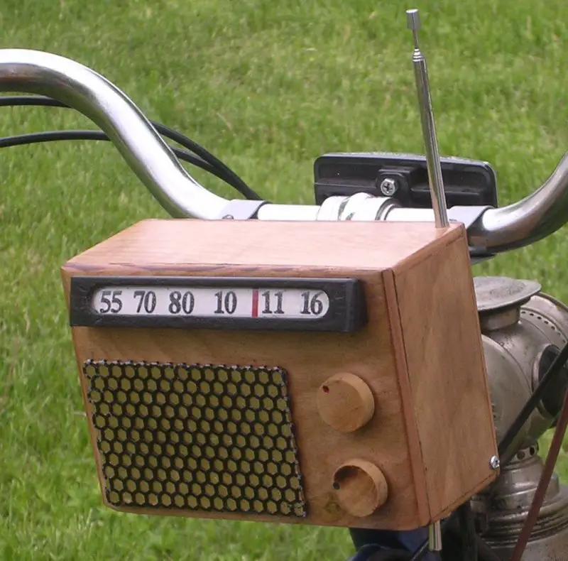

Marathon 037-2.JPG This is how I hid my 12v 7ah battery. Also I run my wiring inside my frame, but I make sure that it does not effect the frame integrety.
