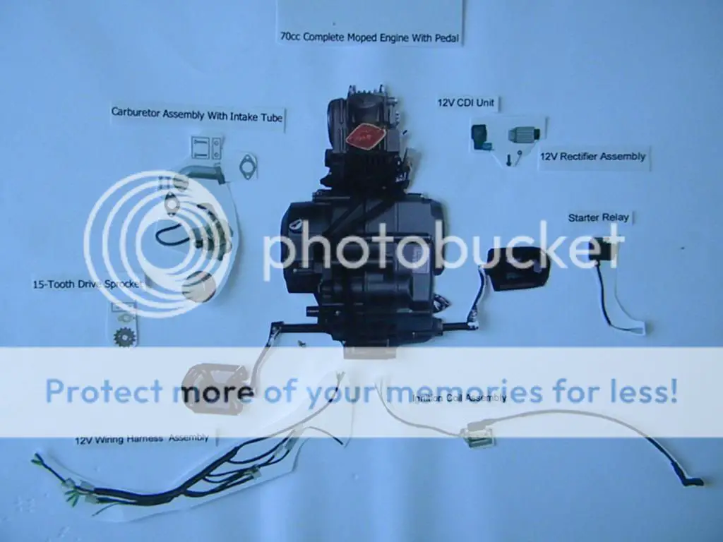

Here's one way with a Chinese Cloned Honda 4-stroke 50cc engine with built in pedal system.
Here's the Honda 4-stroke with pedals, normally the kick start lever is mounted on the shaft where the bicycle pedals are mounted.
This type of engine requires a Long frame such as Stretch Cruiser, or Stretch XL Chopper, or convert your existing chinese pitbike / dirtbike by installing this engine with pedals or on your bicycle remove your existing pedal's & crank.

CH, I know you didn't build it; but how does one start that engine w/o the kick starter??

Well of course not, hope you didn't think I designed or built this mountain bike.
I'm still trying to get 1 engine from manufacturer for testing.
This engine below still needs battery, exhaust, etc etc...
Norm, As for the starting this engine without kick, it has a bottom mount electric starter.
Peace Crazy Horse.
