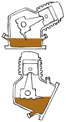

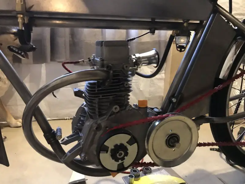

Check out this comparison. My buddy Racie35 turned a 212cc till the mounting plate was at about 105 degrees. I run mine cylinder straight up and down.
Hey moto,thanks for the comparison. The set up I'm thinking about would require the engine to be at around 110-115 degrees. Do you think that would be dangerous or would that end up returning the oiling to a proper level at that point?

As long as the dipper is in oil and slinging oil..you should be fine. I would get motor were it needs to be with side cover off and see what’s going on.

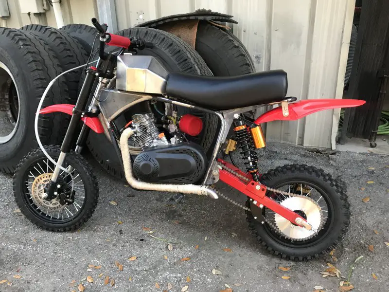

Mine is a 212 is that ok? Also I shaved tank mounts time Tony01 did but I also shaved head and a lot of the casting around flywheel area. It’s cold!!!! I will get you dimensions later today.

What kind of frame is that? Very nice fork.
It started life as a ‘69 Yamaha ct1. Fork is stock ct1; I shortened the legs by 3”. Made my own dropouts for 10mm axle and disc mounts as well, to slim it down for 100mm OLD from the 12x125mm stock spacing. I had a thread “212 build heavy duty” but had to delete the content. I’ll be bringing it back soon.

Wonder if anyone did a SolidWorks rendering with fluid/oil splash and flow dynamics. Lower figure illustrates a greater oil splash than the stock position, and explain excessive breather output. Depressurizing the crankcase may be useful too.

Interesting thought, would depend on where the dipper is, I know Sports car Pat says he added a bit of oil in the bigger engines. Almost have to take the side cover off to tell, what does AGK say?...........Curt

Curt, I don't know if AGK ever intended engines to be any other than stock configuration. I think the Misfit Board Tracker dude installed a sight glass in his engine case. using the #12 illustration one could scale it to a actual engine block to calculate a centerline. At present I am using two cups of oil per fill and getting minimum blow by.
