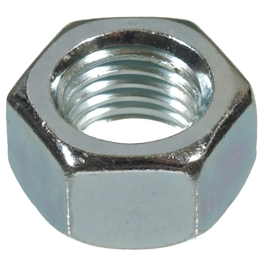

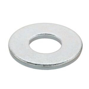

A length of 3/8" all thread rod that is at least a little longer than the spread between the rear dropouts.
Two 3/8" Nuts
Two-four 3/8" ID Flat washers, regular is fine but the larger OD fender washers work great also.
thread nuts onto rod about 4-5" apart, slide washers onto rod on outside of nuts, slide rod down into rear dropouts with bike on it's back resting on seat and bars.
use a 9/16" or 14mm wrench to rotate nut on one side while simply holding rod with other hand and you will start to spread the frame.
you will have to spread it a bit farther than you will need it to be when tool is being used because the frame will spring back a good bit when tension is relieved by backing the nuts back in.
Very simple process and just simple Shade tree mechanic common man tooling is needed.
