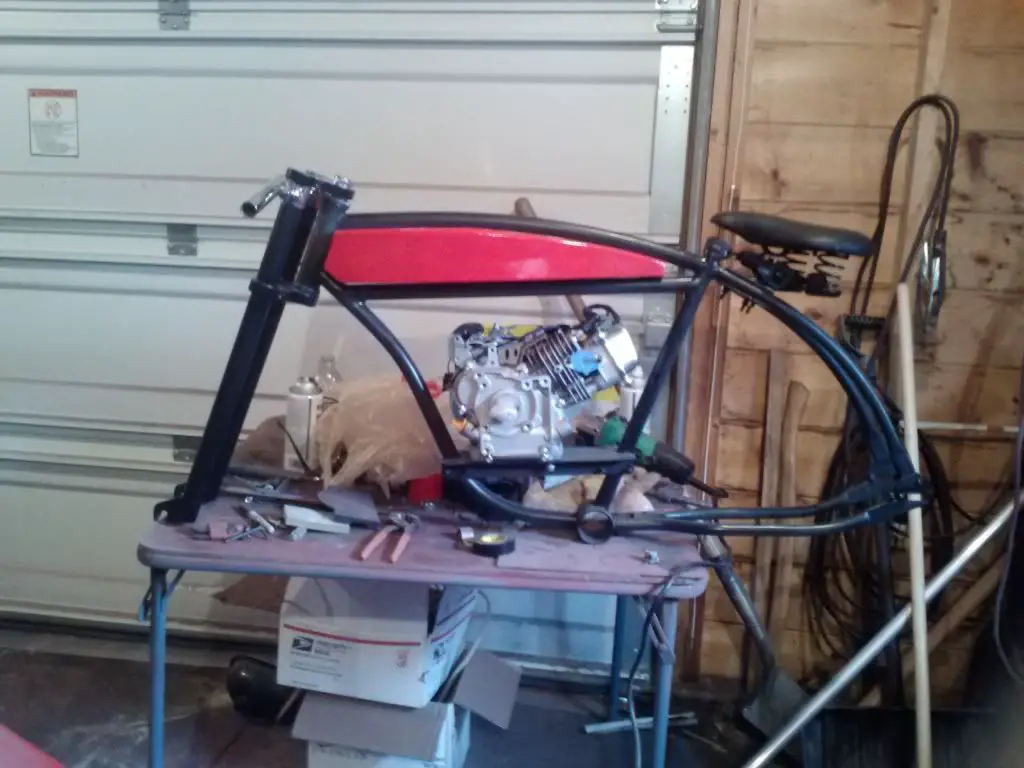

I got the fenders from Worksman today not bad for a couple of months.
Probably won't be able to to fit them till Monday too much going on this weekend with the St.Patrick's Parade on Saturday.

Work is getting in the way but I am going to either make the tank , paint the bike or both if I'm lucky this weekend.That should make for a very long Saturday cause I got sucked into doing a job Sunday.
Finally got tha fenders from Worksman and installed with fabbed heavy duty brackets.
The frame and fork are all broken down and ready to paint.I'm going to spray them with Awlgrip its going to be a combination of Olive Drab and Sable Brown mixed together it should be between Olive Drab and UPS Brown.It should look good with the copper tank.

That's going to be a great looking bike. Worksman makes a good looking frame and their wheels are tops. Their customer service however sucks, as if they just don't care. Hard to understand.
If you would, take some how to type photos as you go with the gas tank. My Tinsmith friend Dan made a copper tank for my Worksman and I love it.

I'll bring my camera to the shop tomorrow.
Just took my first test ride tonight its took awhile to finish with major interruptions like work but the only thing I need now is a layback seat post, mirror and lights.
The weather is going to be nice this weekend here so I hope to break it in.

My kid's 4G cruiser bike doe's about 40 and pushes my 195 lbs up the hill from a standing stop.
So I guess I was going for the look and hopefully more torque so next week the main jet will be drilled out.
Does anyone know the size # drill bit or # jet that they used on the HF 79cc ?I can find the sizes for the HF99cc.
