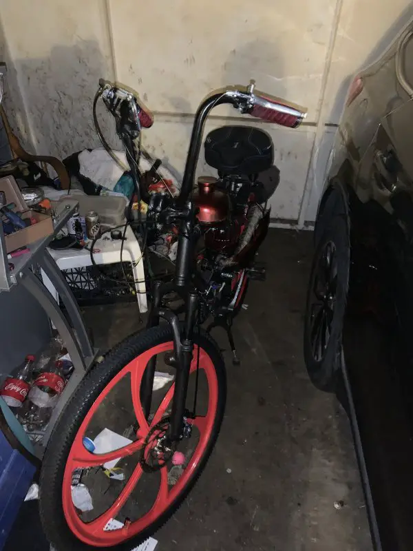

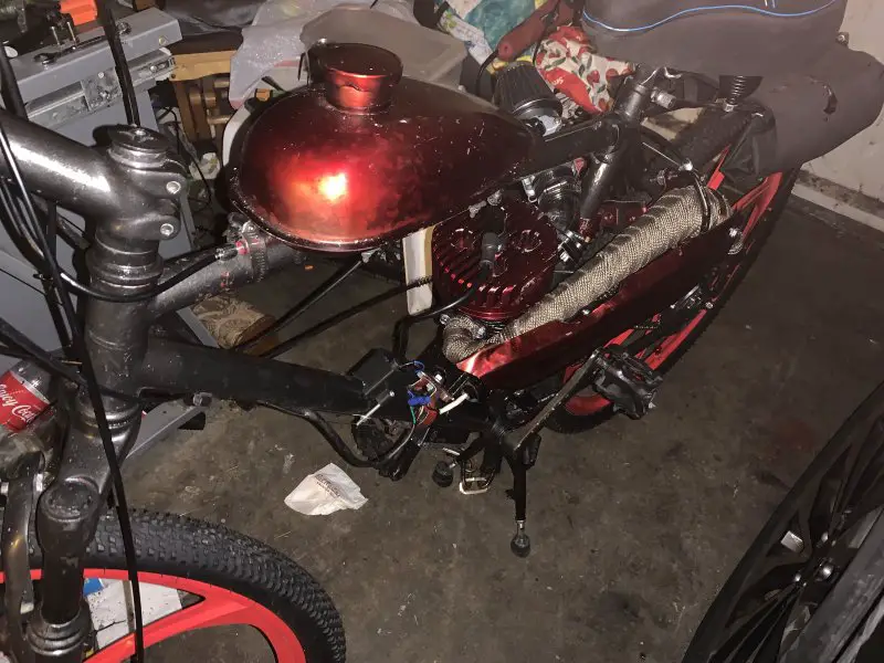

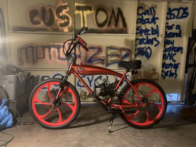

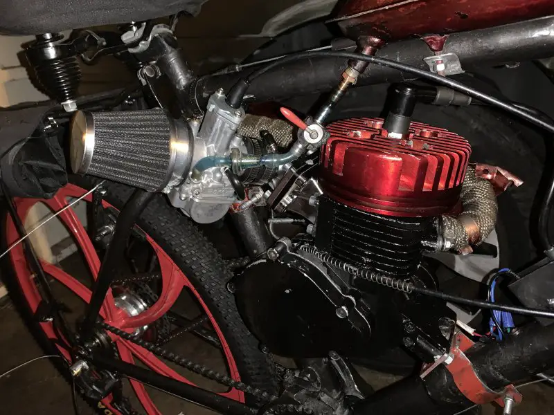

My apologies but I could barely contain my excitement. My bike is finished and it’s possibly the coolest thing i’ve ever ridden! I’m starting a thread over in the Media section if the forum. It will have full pictures, as well as a video from the rider’s seat
And did I mention it was.....INSANELY FAST?!?!? The torque is absolutely incredible, and it tops out at about 55mph with a 36-tooth sprocket right now, and I haven’t even tuned the carb!
I’d absolutely recommend the FRANKENSTEIN 9.5Hp Case-reed motor from Zeda, but only IF you don’t have a problem with heavy modification. I’ll explain more in the thread I post all about it in the media section!!!
