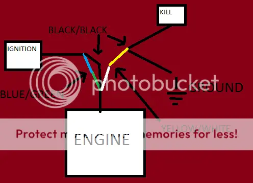

I ended up going to pick up a friend and when I pulled up there was a UPS truck out front. I figured, what the ****, and asked the guy if he had a my box on his truck. I showed him my ID and I went running home with my kit. Its been a few hours and a few adult sodas and it nearly done. I have a few issues that I need some help with. I might as well post it here for anyone following this thread. From the engine there is green , black, white.. From the Ignition bow there is blue and black and the kill switch has black and yellow.. The instructions are wrong and do not have the wire color combos in them.. My thought was from the engine to the ignition black to black green to blue, white goes to the yellow from the kill switch and the black lead goes to ground. I will include a crappy diagram lol.

I stole these instructions from another post here, but it explains how mine wired up:
Connected black CDI wire to black engine wire.
Connected blue CDI wire to blue engine wire.
Snipped-off engine white wire "not needed unless running a headlight, not recommended as it robs engine ignition power requirements"
Connected the two kill switch wires to the remaining two holes of the CDI terminals. "Color code not important".
The white wire supplies 6V power from the motor for lights, people usually just cap it off and do not use it, figuring the little HTs need to keep all the power they can for spark, lol.
My CDI wires ended in what looks like big female spade connectors. One on side of the spade connector you insert a wire from the motor, the other side gets a wire from the kill switch...
Hopefully that helps make things a little clearer, assuming your kit is set up like mine was.

Dan and Maurtis thanks for following along.. So from what I Understand the kill switch will go to my blue and black wires off the ignition coil. I have not put my meter on it yet but my assumption is that the kill switch is normally open so pressing that button shorts out the power and ground to the coil and in turn stops the engine. Right?
Correct. And good call on letting someone else handle the frustration of the rag joint! I tried for an entire day to get mine straight, but it was always off just a little. I gave up and just ordered a hub adapter from Pirate Cycles instead, lol.

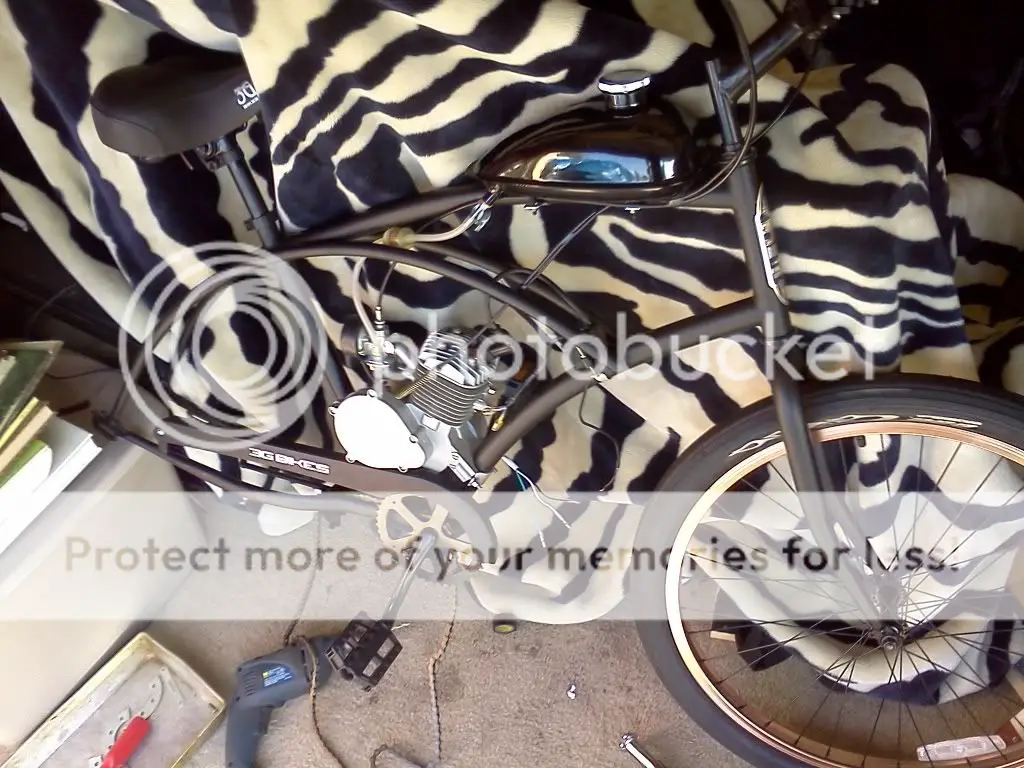

Its too sunny outside, and too dark inside for good pictures this is all I was able to get.. It looks much better in person. In fact I almost did not want to post a pic for that reason but here it is so far.
