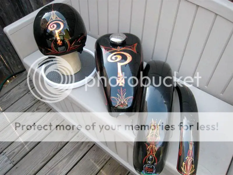

Gene's Indian Larry Tribute Custom Paint:
