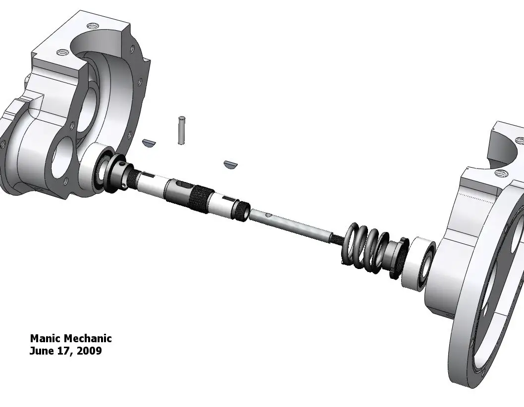

You said it won't move, is the chain on it? If so the chain may be binding on the case. All that's inside the cases is a couple of bearings and the clutch spring, remove the clutch cable stand off which is almost directly over the center of the clutch shaft to add a little grease, some engines I've broke down didn't have sealed bearings and needed lubing. If you pry on the gear will it turn?

first, you need to find why it won't move - you have pressure plate off, so take out plug and see if it moves or if it shows not even a little motion on motion on clutch side trying to move the gears
if there is no motion, take off chain and try to turn nut in drive sprocket clockwise with your plug wrench - it it turns, then it is a chain problem, if not, it is a shaft or bearing problem
I would suspect a chain problem tho as that's what it usually is.
