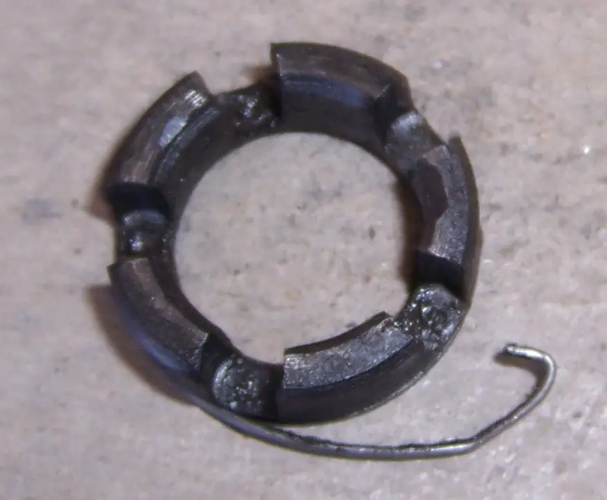

Wasn't connected to anything. The picture of the clutch bell is as it came off the motor. The spring was not connected to anything. It might have been shoved into the hole on the lower right, in the pictured, where the bell is welded.
Lordo
That was the problem!!!!
Gotta love it when a guess turns out right.
It was letting the Brg. race move back an forth.
Hook it back up and your good to go...POPSdance1
I hooked it up to nothing and it worked like expected, but that was just to see what was going on. I did go back and hook it up, but I need a break before I take it out and test run it. I got tired. I think a trip to the bar tonight, a cocktail and a ride back should tell me all is well. Beside the current temp is 36 C a bit warm.

Thank-you very much for the compliment. The only reason I know so much about the C/clutch is I wanted to make mine free-wheel both ways, to eliminate the clutch lever off the handle bars.
Because, gas bikes are so illegal here, I am building two mountain climbers for Mumzie and Me and C/clutch is the only way to go.
If your clutch gives you problems again, I would take the spring out and pre-load the Brg. race to the right and tack weld it, in two spots.

Pic 1 centrifugal clutch cover off. Pic 2 Spring connection.
It seems to be working.

Let me know if I did it right.
lordoflightaz
You got it right.
Thanks for the pic's
You are a good wrench to be able to follow
my (wordy) instructions, with out pic's and
get her done. Good on you...POPS
One last add to this thread.
An easy way to make it freewheel both
ways is to remove the spring and put
A 180 degree twist on the end that hooks
into 1 of the 5 holes in the bell and reverse
the spring so it preloads to the left...POPS
